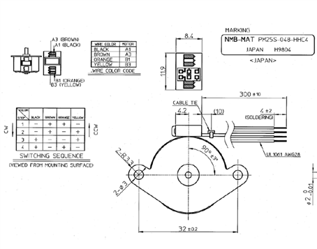

Can anyone or an expert help provide an answer:  I have the above NMB TECHNOLOGIES - PM25S-048-HHC4 - STEPPER MOTOR, PERMANENT MAGNET  and wish to set it up for class.
I understand and am able to connect other motors but lack the understanding of how to setup this one.  Can someone send me a circuit showing how to attach the
four leads and if other components are needed to get the motor to turn.  My email is rbolick@ecpi.edu.

    The faster and easier way is using a driver between your logic control circuitry (normally microcontroller) and your stepper motor, like this one:
    https://www.sparkfun.com/products/10267
    You should check the current characteristics of the stepper motor for chosing a rigth driver!!!
    Hope it helps!!

    You can also check this tuto:
    https://www.sparkfun.com/tutorials/400
