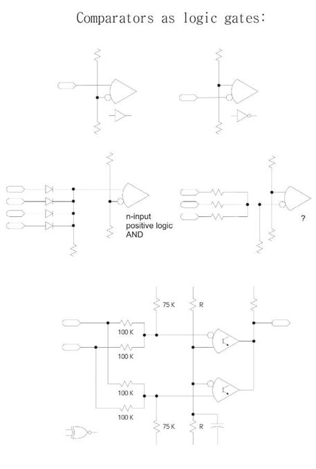

    The fourth one, presuming the input resistors are all 100K, what logic gate is it when the pull-down is:
    1) 125K?
    2) 75K?
    3) 40K?
    What's this?
  • D_Hersey
    D_Hersey over 11 years ago in reply to D_Hersey
    nor gate
    inverting majority gate
    nand gate
    this is the schematic symbol of a Norton operational amplifier.  A classic example is the quad lm3900.
