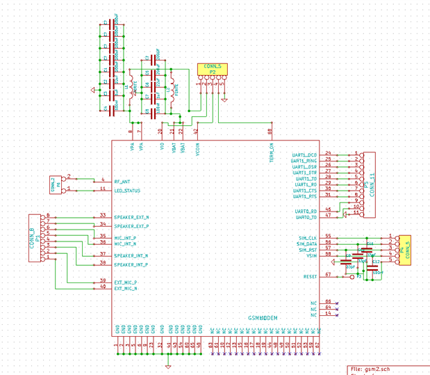

I have a Mg323-b,but I don't succeed in communicating with it in UART.
I'm using a FT230X in order to communicate via UART (though it does not support for DTR/DSR). I've allready used this FT230X to talk to a wide range of UART devices without ever a problem like this one.
When I power  the Mg323 module I get on UART1 "IIII 0XFF 0XFF 0XFF 0XFF ^SYSSTART" and "^SHUTDOWN" When I power it down.But other than that it does not respond to any command like "AT".
On UART0 I don't get anything, and it does not respond to anything either.
I've tried almost all possible UART configuration .

    What do you use as a host?
    Is it possible that you send extra characters after the AT command?
    You have to send only AT<CR> because any other character after the CR typically stops the executon of previous command

    I searched for mg323 on the web, and I found out this code refers to an SOC. What is the code of the board the Mg323-b is soldered on?

    Custom Board.
    Though I seem to have followed all specifications given in hardware design guide. (I'm used to design way more complex boards.)
  • amgalbu
    amgalbu over 10 years ago in reply to Former Member
    You mean you built the board? Do you have a schematic?

    Here is the schematic I used
    I connected a battery Beetween P2.1 and P2.5, a pushbutton between P2.4 and P2.5 to power it on, and a led between P6.1 and ground which blinks at 1 hz when I power the module on, which is normal.
    Concerning UART0 do you mean that in order to use it, it must be activated softwarly trhough UART1 before?
    A problem that I could have is that my FT230X AUART To USB converter does not support DTR/DSR. On top of that I've noticed that if I let them unplugged, DTR is up (probably a pull up resistor), But DSR is low! Should it mean the module is not ready to communicate?
    [EDIT] I also Connected a 200UF capacitor between VCoin and ground.

    I feel a litlle bit shamefull about it, but I just noticed that There was an obvious soldering problem on TX. Sorry for bothering you.
    Though I still have something strange: the modules keeps sending the same thing over and over again. I don't know if it is normal.

    Now everything is working fine (I had a last little solder bridge).
