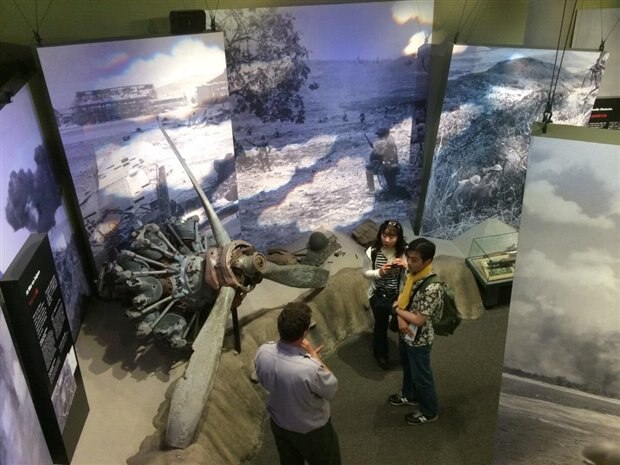

    Hi Peter and Mark,
    Thanks for taking time to respond.  The original installation is shown below.  I hope you can enlarge it to read it.  I am based at the NPS Design Center in Harpers Ferry WV, but the installation is at the American Memorial in Saipan, so Peter, I am not worried about you showing up to rob me image.  One section of the exhibit is below.The web site is www.nps.gov/AMME.  I travelled there 2 weeks ago to do the preliminary exhibit upgrade, am going back in a few weeks to finish up. The alarms are only one part of the job.  Anyway, Zones 1,4,6 each have one PIR.  Zones 2,3,5 each have two PIRs in parallel.  The BBI Custom show controller on the left and the 6-channel Crown amplifier have been replaced with six individual Akman SR-8 players.  Each player feeds a separate alarm speaker located in the area that is alarmed. this is shown in WIRING DETAILS, top diagram, so a single relay would not work.  The other WIRING DETAILS are for other elements of the exhibit.
    Yes, I am sure the existing PIRs are form A (NC) only.
    Is it correct to assume I would need 9 relays to convert the NC contacts to NO contacts?  Amy specifics regarding manufacturer and model and how to wire would be appreciated.  Again, 12VDC and 120VAC is readily available.
