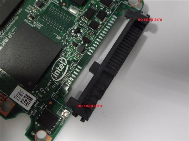

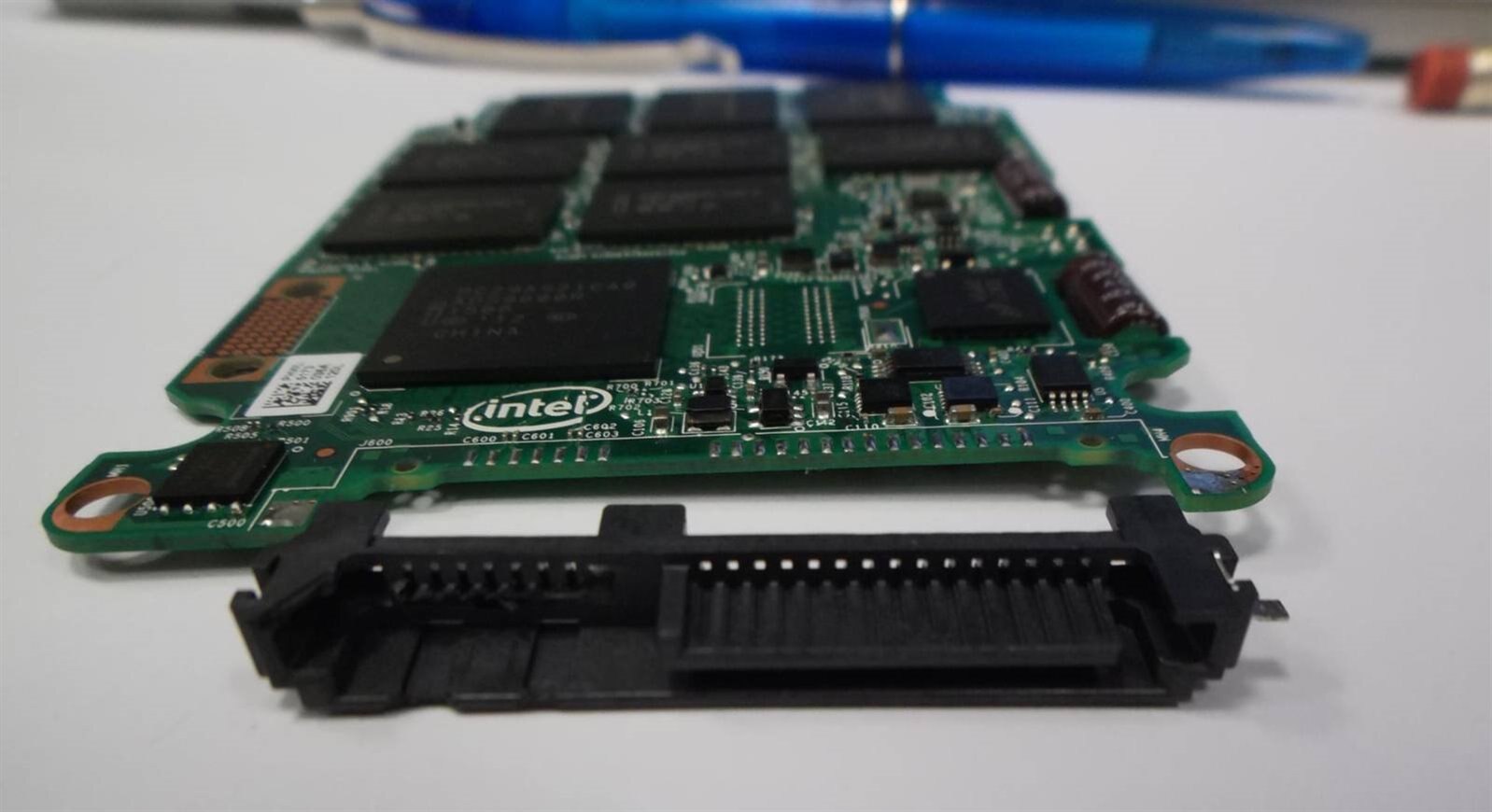

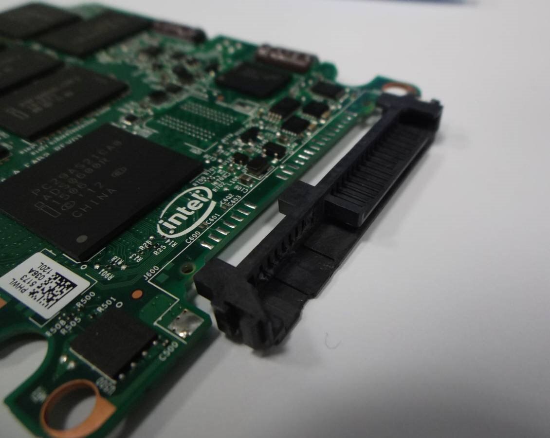

Hallo,
ich bin auf der Suche nach einem SATA Anschlusstecker/Steckerleiste für eine Intel SSD S3500 120GB.
So sieht diese, leider beschädigt aus:
Können Sie mir vielleicht sagen, wo ich genau diese Steckerleiste zum einlöten beziehen kann?

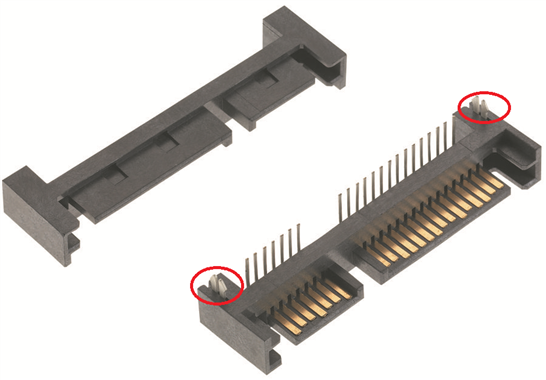

    Try these:
    5622-6309-ML - 3M - SATA CONNECTOR, PLUG, 22 POSITION, SMD | element14 India
    5622-4100-ML - 3M - Connector Type:SATA | element14 India
    You only need to tweak those connector pins..

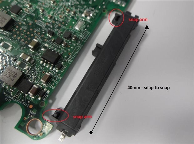

    0 e14 Contributor over 10 years ago in reply to mudz
    dear mudz,
    sorry, but these are false, too.
    i need a connector which had snap arms by the other side:
  • mudz
    0 mudz over 10 years ago in reply to e14 Contributor
    Well they do have snaps.. and those snaps will lock it to your pcb..
    Well you can google Sata Connectors or you can go to your local computer market and ask for the same.. If you could not find any I suggest you to buy one of these and do some "JUGAAD" with it.. We do it all the time here.. JUGAAD means innovative fix,. Someday I will write a blog on "JUGAAD" image
    for example
    JUGAAD 1:
    My suggestion is to buy these and try it, if snaps fits then all good if it does not, just remove the snaps and solder those connector pins. Soldering will hold your connector & does not let your connector move. But to be on safe side just drop 2 drops of super glue on each side of snaps.
    the snaps are on the false side!
