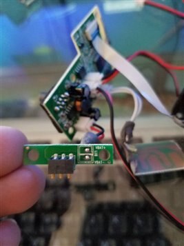

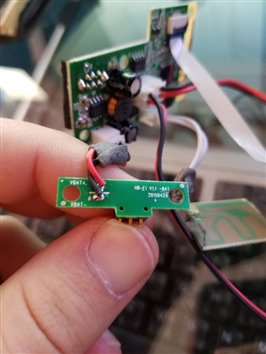

I've taken apart a bluetooth speaker that ran on a 3.7V  1500 mAh battery. I want to run it off of wall power, but the battery has three terminals.
I'm assuming the middle terminal from the battery is to check the charge, but how would I bypass that? It doesn't work without the middle terminal.

    Hi Chas,
    There is a red and black wire that come from the battery interface board. I suspect that it will work if you put  plus 3.7 volts on the red wire and the negative terminal on the black wire. Be careful if you are using a wall wart as the board may not be able to tolerate much more than 3.7 volts. Test the power supply for the proper voltage and also make sure it has the current capacity to run the speakers amplifier. A battery can deliver quite a lot of peak current. If you want take a couple more pictures and post them so I can get a better look at the circuit before you go further it wouldn't hurt.

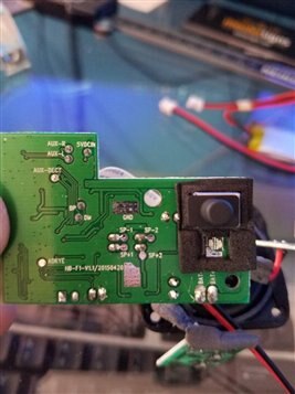

    I too, though that I could power the board through the red and black terminal. I had some 3.7V batteries from adafruit that have the same connector but when I plug them in, I get nothing. I checked them with a multimeter to make sure they're giving off the correct voltage and they are.
    The small circuit board that has the 3 battery terminals on it doesn't seem to have any components, but some how the leads go from 3 to 2.
    Just to be clear, I want to completely eliminate the battery from this device while still being able to power it. The micro-usb port on one of the boards is only there to charge the battery. The device will not function while it is plugged in.

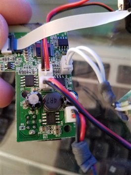

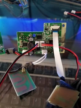

    0 jw0752 over 10 years ago in reply to e14 Contributor
    Hi Chas,
    Great pictures and they make me more confident in my first advice. mcb1 has a good suggestion to add a capacitor across the power input line. I would suggest a 470 uF to 1000 uF. at 16 Volts. Make certain that you connect the negative to the negative and the positive to the positive. I do not see any reason why your other battery didn't work but you could verify that you have the requisite 3 to 4 volts on the BT2 terminals by taking your meter and checking when the battery is attached. Good luck and let us know when you get it working.

    0 mcb1 over 10 years ago in reply to e14 Contributor
    Three pins at the battery end are often for charging purposes.
    They detect the voltage at the battery end of the cable and whatever is inside the battery protection circuitry, which overcomes any cable resistance.
    I suspect this is where your 'three to two' is coming from.
    There are plenty of points to connect a supply to on the boards in the photos.
    Yes sometimes the USB is just a charger connection.
