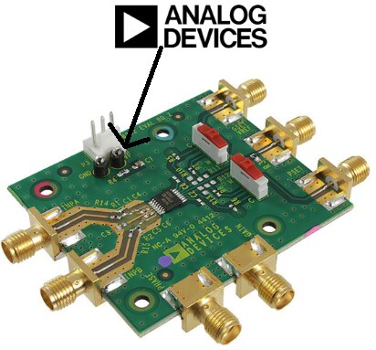

Hello,
I am an M.tech. student in electrical Engineering department of IIT Kanpur. Our department had purchased one AD8302 evaluation board from Element14. I don't know whether I am doing something wrong or there is some problem in the board but I am not getting any well- defined output. Also, its Vref port is giving 20 volts instead of 1.8 volts.
So, please help me in handling the device and also tell me how the output should look like?

    michaelkellett over 9 years ago +1
    The supply voltage to the board should be 5V so if you have 20V at the Vref port then you have the wrong supply, a massive overload input signal or some other problem. Check out all the connections and…

    The supply voltage to the board should be 5V so if you have 20V at the Vref port then you have the wrong supply, a massive overload input signal or some other problem. Check out all the connections and post a schematic or picture of your test setup.

    Thank you for the reply but what actually I want to ask is the output of the Vmag and Vphs pins on DSO be look like?
    I am testing the board by applying 5V to Vp pin and Gnd at gnd pin and  sinusoidal signals at frequency 50MHz with mag -30dbm to both INPA and INPB.
    And I am looking the output on DSO.
    So, my question is that what output should I get on DSO? should it be a sine wave or triangular wave or anything else ?
    what I am getting is varying output i.e output is not stable.

    one more thing I am connecting that 5V biasing by connecting the wire from power supply at the round pin named Vp as marked by arrow nd gnd at the other pin.image

    Are the 2 input signals in phase with each other or are they random?
    Also, how are you connecting the DSO for measurement? The outputs come from the terminals marked phase and gain on the bottom of the board. the signals come from the inside of the connector, the outside part is grounded. A Scope probe should be getting a signal from the centre of each pin, the ground clips on the scopes should be connected to a ground point.
