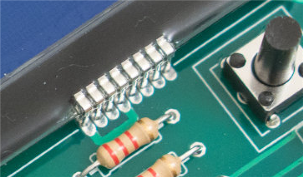

    0 shabaz over 7 years ago in reply to bobsid
    Hi Bob,
    There might be a connecter out there for it, but as I understand it a delicate attachment to glass, so usually intended for direct soldering
    (or very few removals perhaps).
    Oval through-hole pads work nicely on 1.27mm pitch:
    With larger 2.54mm pitch, pin sockets can be used, although there is a risk of pins buckling when inserting:
    Hi Bob,
