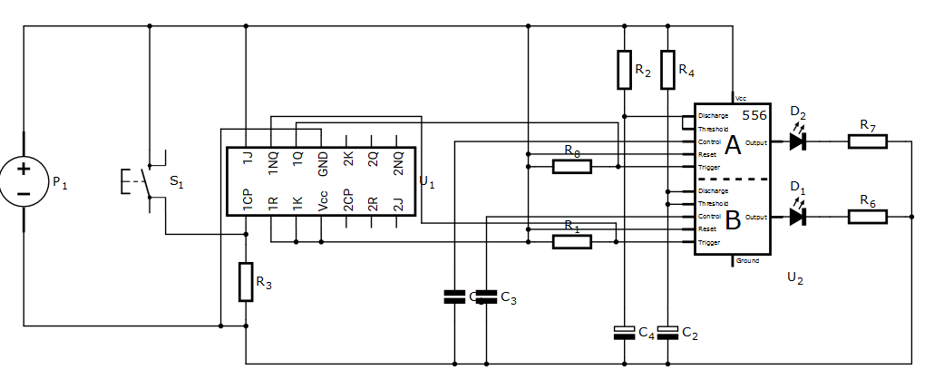

Hi Guys,
I am learning as I go here and I have set myself a challenge...
My guitar amp is switched by a 4 button footswitch all switches are momentary and the channel switching logic is done (I believe) in the amp by a pulse to ground over each switch.
Clean, OD1, OD2 & Reverb
The footswitch is connected over a DSub9 and the pinouts (from memory) are:
1 - Clean LED Anode
2 - OD1 LED Anode
3 - OD2 LED Anode
4 - Reverb LED Anode
5 - 0v
6 - Clean
7 - OD1
8 - OD2
9 - Reverb
What I'd like to do is repurpose the switch on OD2 for something else, so I was thinking I could use the OD1 switch as a toggle between OD1 & OD2 modes. The research I've done has led me to believe that I can do this by using a combination of JK Flip-Flop and 556 (or 2x 555) timer as a one-shot monostable:
Here is my circuit, is this right? What's missing and what resistor values do you suggest I use to with the 10uF polarised caps I'm going to use to allow a very quick pulse (HIGH) from the 556?:
The 556 outputs will go to a pair of NPN's (not LED's as shown) that will pull the pins 7 or 8 to 0v (pin 5)

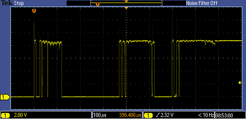

    Starting at the beginning, the switch will almost certainly bounce when you press it. [The contact, instead of landing cleanly, bounces and then breaks and makes a few times before settling. If you have…
  • jc2048
    0 jc2048 over 9 years ago
    Starting at the beginning, the switch will almost certainly bounce when you press it. [The contact, instead of landing cleanly, bounces and then breaks and makes a few times before settling. If you have an oscilloscope, wire up just the switch and the resistor and capture the waveform.]
    So you'll probably need to debounce the switch to stop it clocking the flip-flop more than once.

    Hi Jon,
    Thanks I think the pedal already has some de-bounce circuitry on the momentary switch. If not I will heed your advice. What would be the best way to debounce a switch that is providing a 5v pulse to the CLK input that is pulled low?
    I have worked on the circuit some more and eliminated the 555 timer.
    Am I barking up the wrong tree?
