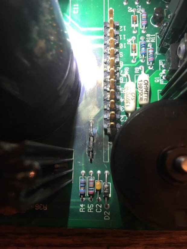

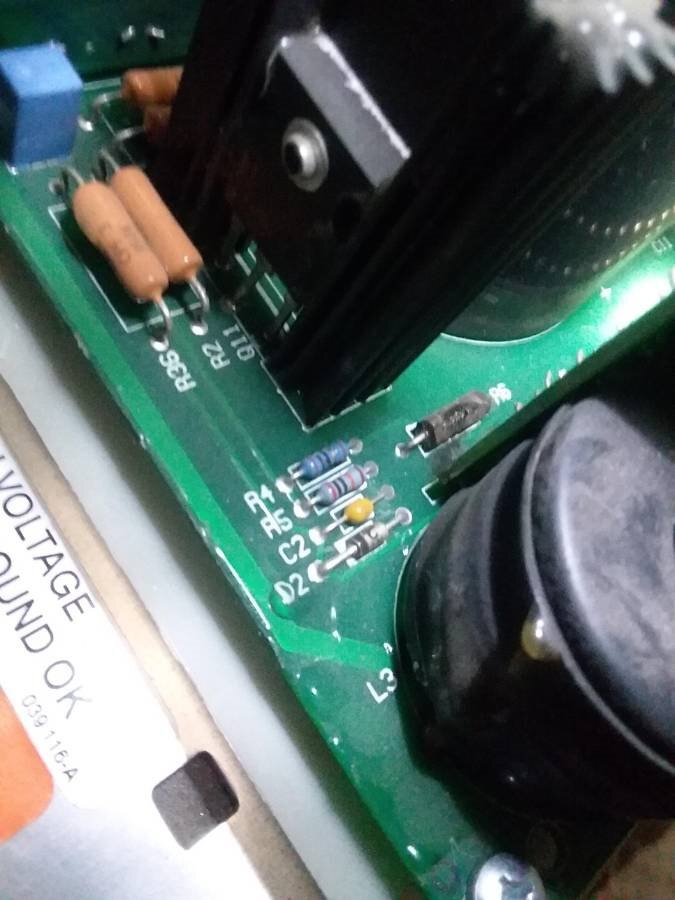

I have a miller welder that blew some resistors and a voltage regulator on 2 boards. I can buy new boards but that's around $2,000. the resistors are burnt to the point I don't know what size they are. I've tried contacting Miller Electric but they told me they can't send me any info on the boards. Can anyone help me with this? I don't know a lot about electronics. Part numbers for the two boards are 207818 PC2 and 200841 PC10. imageimage
    dougw over 9 years ago +5 suggested
    The damage in the bottom picture to the resistor and Q11 are not from a little gentle overload - they look like massive catastrophic overload - as in perhaps mains voltage got shorted across them. Simply…
    jw0752 over 9 years ago +4 suggested
    Hi Billy. If you know anyone else with one of these units perhaps they would give you a quick look so you could note the color bands on their resistors. Other than that, like dougw said there are going…
    dougw over 9 years ago in reply to bd467 +4 suggested
    The damage on Q11 probably caused that noise. Thermal expansion stress due to very rapid localized increase in temperature (as a result of excessive current) causes the chip package to explode. The onset…

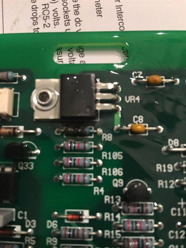

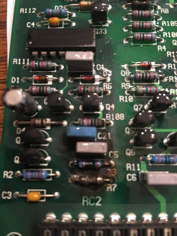

    0 bd467 over 9 years ago
    Here's what I got last night. I'm thinking R8 is the same value as R105, R106 and R4. I hooked my multimeter up and got the resistance. I was also thinking R7 is the same value as R6 based on the resistance being the same. R108 looks stressed as well. I'm willing to try and repair these boards. based off the color bands what resistors am I looking for. my eyesight isn't the best but R8 looks like red black black red brown 20kohm 1% is that correct? R108 Orange red black black brown 320ohm 1%. R6 I'm not sure on the colors. I'm using a resistor calculator I found online. Feed back please and where can I buy these.
    Forgot to upload this one. This is the resistor by Q11.

    0 dougw over 9 years ago in reply to bd467
    R108 looks like brown black black red (10K) to me - use your meter to confirm this.
    These are all 1/4 watt metal film resistors.
    http://canada.newark.com/w/c/passive-components/resistors-fixed-value/through-hole-resistors?resistor-case-style=axial-l…
    What value does your meter read for R6, R7, R8, R108?
    This resistor is physically larger - probably 1 W and probably a fairly low value.

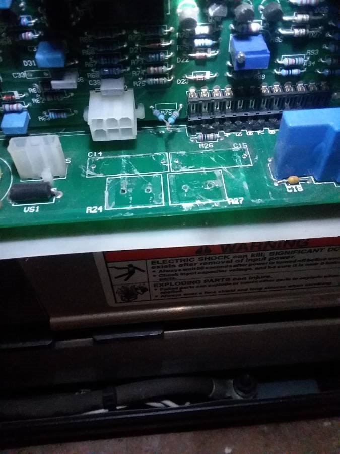

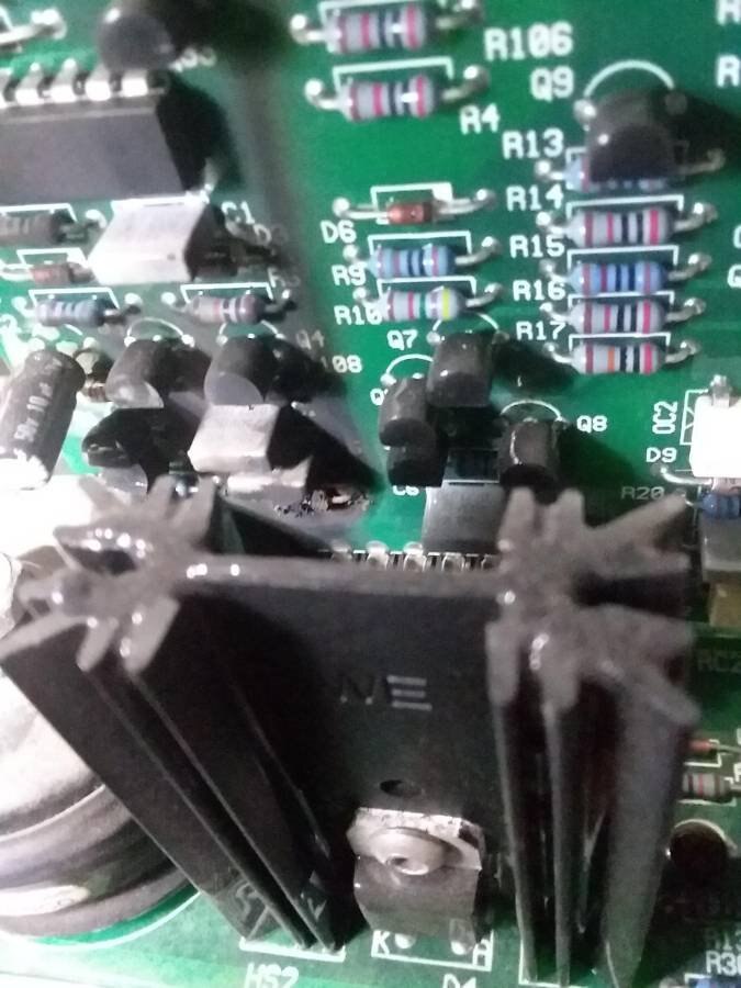

    0 rollinsparta over 8 years ago
    I have the same boards in my welder; it's a Dynasty 200 made in December 2007. Bought it yesterday knowing it didn't work with the intent to get it running. So far, I have taken off the cover and am in the middle of visual analysis/prepower testing. I have those same 2 resistors burnt below r108. Also my resistor r6 is burnt near q11 on pc2 207818. Let me know if you need any more pictures/specs. Mine is missing r24, r27, c14, and c15 on pc2. Can you send me pics/specs of those? Thanks!imageimageimage
