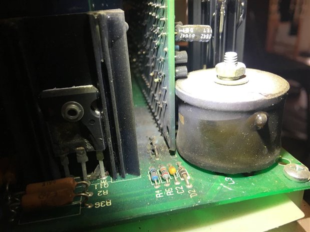

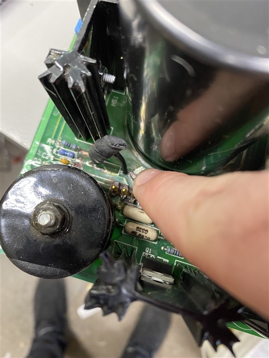

I have a miller welder that blew some resistors and a voltage regulator on 2 boards. I can buy new boards but that's around $2,000. the resistors are burnt to the point I don't know what size they are. I've tried contacting Miller Electric but they told me they can't send me any info on the boards. Can anyone help me with this? I don't know a lot about electronics. Part numbers for the two boards are 207818 PC2 and 200841 PC10. imageimage

    The damage in the bottom picture to the resistor and Q11 are not from a little gentle overload - they look like massive catastrophic overload - as in perhaps mains voltage got shorted across them. Simply replacing these components will not fix the reason they blew. You need to track down where the high current short occurred and fix that too.
    If you trace out the circuit, you can often deduce what the resistor values should be.
    Have you tried measuring the value of R6 and R7 - they may still be somewhat intact.

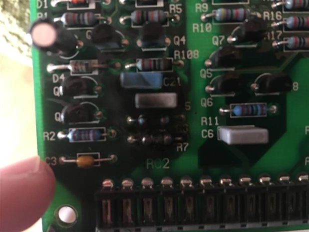

    If my mage enhancement is accurate, there may be a couple of blown transistors on the top card as well?
    D4 also looks stressed?

    I will upload some better pics when I get home tonight.

    John I don't know anyone with the same welder. I've searched the internet for pictures of the boards with no luck finding anything. Just before the smoke there was a loud bang, sounded like a gun shot and then smoke.

    The damage on Q11 probably caused that noise. Thermal expansion stress due to very rapid localized increase in temperature (as a result of excessive current) causes the chip package to explode. The onset of high current needs to be very sudden for the exterior to still be cold when the inside reaches a high temperature.
    The resistor that evaporated might have made a noise too although I've smoked lots of resistors without generating much noise.

    If you still have the piece that chipped off Q11 it may have some marking that would help identify it.
    • Reject Answer
  • bd467
    0 bd467 over 9 years ago
    Q11 G4ph50ud

    Your Q11 number corresponds to an IG4PH50UD which is an Insulated Gate Bipolar Transistor with an Ultra Fast Recovery Diode. Here is a link to the Data Sheet if you want more information.
    http://datasheet.octopart.com/IRG4PH50UDPBF-International-Rectifier-datasheet-561823.pdf
    It is likely that the IG4PH50UD took out the resistors so if we can determine what the values of the resistors are it would be worth your while to at least try to replace the IGBT and the resistors and give it a try. If the new board is $2000 it is really worth a try.
