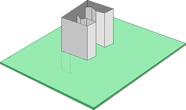

I'm developing kind of relay board and looking for metal contacts for standard (e.g. European) AC power plug which can be mounted to PCB so that AC plug goes throug PCB:
I think it should be something like those ones that used in wall outlets.
Searched for a month, but found nothing. Does anybody knows where to buy such things?

    This isn't something I have really thought about doing before, it's probably hard to find this sort of thing because there are all sorts of safety implications and clearances required when dealing with mains voltages.
    I did do a quick search and the closest thing I can find to what you are looking for is something like this: http://uk.farnell.com/te-connectivity-amp/1744128-3/pcb-contact-pin-solder/dp/2102402?ost=1744128-3&scope=partnumberlookahead&exaMfpn=true&searchref=searchlookahead&iscrfnonsku=false&ddkey=http%3Aen-GB%2FElement14_United_Kingdom%2Fw%2Fsearch
    However, there aren't any details on it's electrical specs so it may not be suitably rated for this application and I am not sure whether you'd be able to make it mechanically work given you want to plug through the PCB so you'll be putting a cut out in the board where the mounting pad will likely need to be, and even if you can get that to work, will there be enough rigidity or will the connector fingers flex the PCB too much as the plug is inserted?

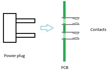

    OK, let me summarize:
    1) power plug to contacts is OK (all the world use it in power outlets
    2) AC on PCB is allowed (used in lots of applications)
    3) Fuse holders on PCB are totally allowed (used in lots of applications)
    But contacts similar to fuse holders on PCB not allowed all the sudden? Why?

    But, if you think about the difference between building a mains socket into a PCB and a fuse mounted in a fuse holder on a PCB from a mechanical perspective:
    1) A fuse is inserted and it remains in place potentially for a very long time until it blows and is replaced, however a plug may be removed and inserted many times. The mechanical stresses of repeated insertion and removal will be significant compared with just inserting and leaving.
    2) The fuse sits in the fuse holder connectors on the PCB, there is no hole required in the PCB through which to insert the fuse. The scheme you outline above required a hole in the PCB for the plug pin to pass through. This is right next to where any PCB mounted fingers would be located, causing a weakness in the PCB at this point allowing more flexing and providing a point which could fail over time.
    3) The fuse and fuse holder connectors are fairly low to the PCB and there isn't any leverage to exert forces on the PCB. With the PCB mounted fingers and the plug pins being long in comparison, there is much more leverage for causing forces in the PCB in the right direction for causing failure points as described in item 2 above over time.
    I'm not saying I am definitely right and that you can't do this, but I can see potential issues which may make it difficult and explain why you've not found anything suitable in your searching so far.
    Anyway, good luck with your project. I hope you find a solution which works for what you need to achieve.

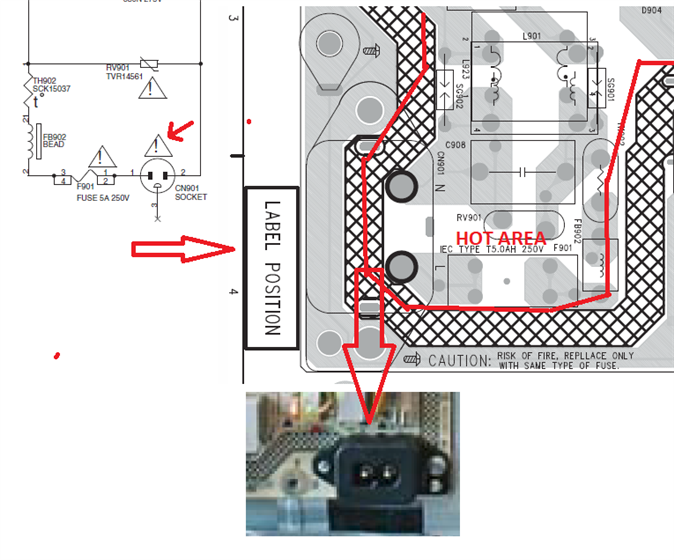

  • geralds
    0 geralds over 8 years ago in reply to x_arrange
    Hi,
    please don't mismatch that different issues.
    A fuse would not often unplugged, just if you have to change that fuse.
    But a power cord you can plug in or unplug out every time.
    So this both of this issues you can't compare directly.
    Because "there are many on the PCB",,, hm, yes, it works often, but is this right?
    Main power is on the PCB, yes - AND you have the instruction with it.
    An example, the power plug for a flat TV: schematic, PCB drawing, an a real photograph
    The outlet is mechanical stabil (have its housing for the contacts), and is directly mounted on the PCB.
    The same you can build with the "SCHUKO" (german: Schutzkontakt-Stecker) - Plug; an outlet with the Earth contact.
    It works! BUT... wow!!! image

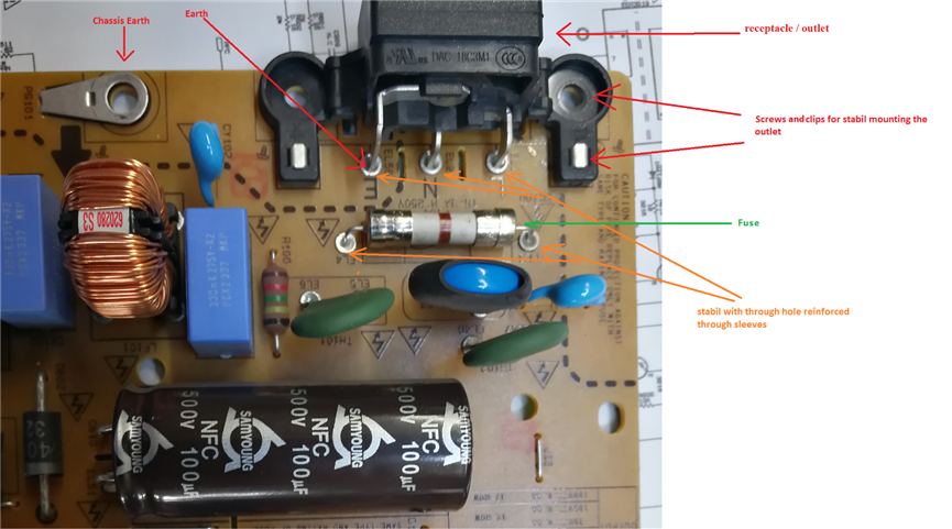

    0 dougw over 8 years ago in reply to x_arrange
    I don't know the standards in Europe, but as far as design practices go, a receptacle needs to have appropriate 3 dimensional mechanical strength. Solder joints are not considered to be adequate for repeated mechanical stress and PCBs are 2 dimensional, so the 3 dimensional mechanical superstructure of a receptacle should be bolted to a PCB, which may need to be extra thick depending on the size and forces involved. I think the reason it is rare to see an AC socket directly on a PCB is it is hard to isolate the mechanical stress on the solder joints. There are PCB mounted power entry connectors in North America, but they generally bolt on to the PCB and the solder pins are generally designed to flex and avoid mechanical stress.

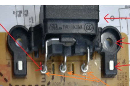

  • geralds
    0 geralds over 8 years ago in reply to dougw
    exactly.
    This is what i showed above.
    Also here in this example: the outlet with an Earth connector.
    Best Regards
    Gerald
    • Reject Answer
  • viswambher
    0 viswambher over 6 years ago in reply to geralds
    How did you create this part or where did you buy it?image
