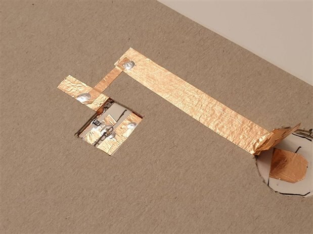

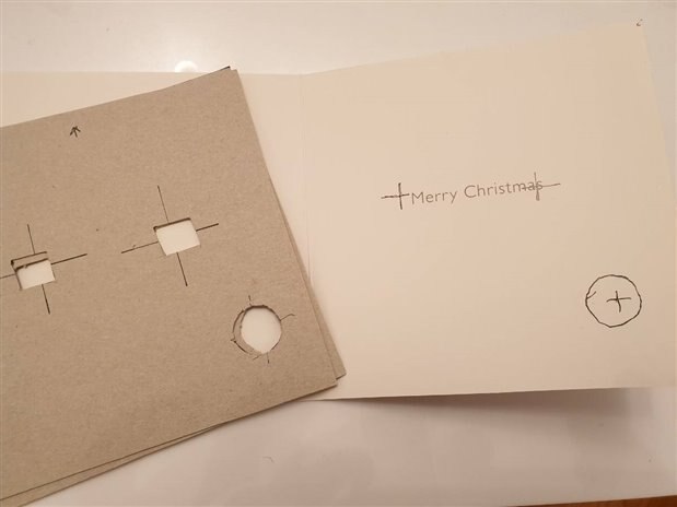

    First off I cut a couple of pieces of cornflakes packet cardboard : ) I used a pin/needle to mark where the LEDs were needed by pressing through the front of the greetings card, and then cut out the squares, and also a circle for the battery.

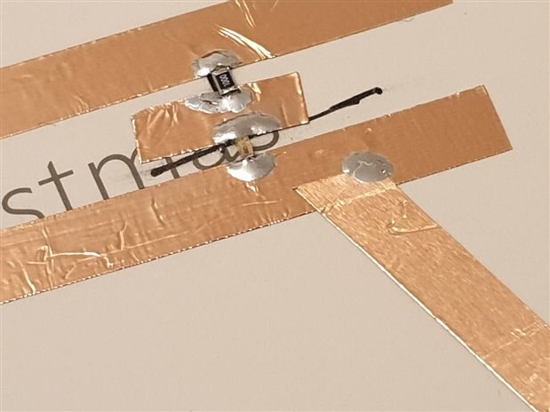

    The LED and resistors were soldered here. The bottom is the LED cathode/negative rail. The top is the positive rail:

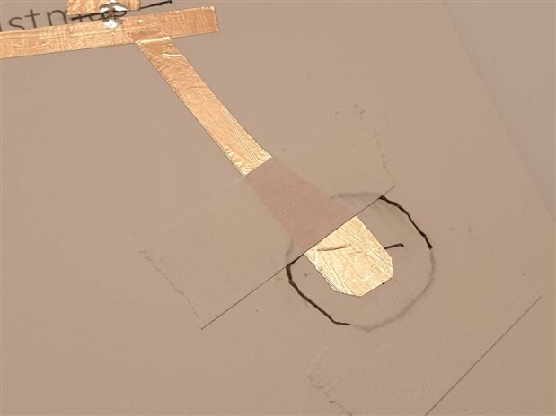

    Some tape over the battery area, so that the card needs to be pressed to make contact:
    Closer view of resistor and LED. Any copper tape joins needed to be soldered, since the adhesive is not conductive (some tape has conductive adhesive, but that is more specialist stuff)

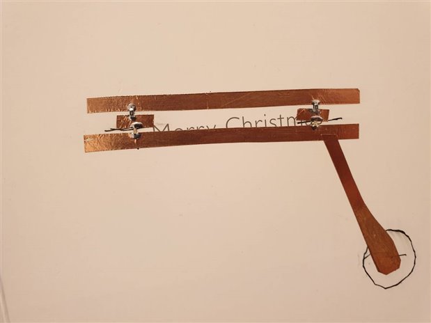

    After gluing on the card, I made the positive connection, again soldering wherever there was a join. The battery tab was made by folding over the tape so that it wasn't adhesive there any more:
    Battery held in place with a bit of tape:

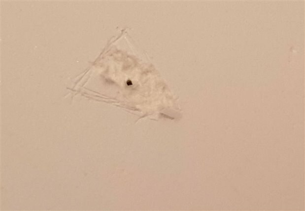

    The LEDs I had were too small (0603) and also not very bright : ( So I had to use a scalpel to cut out some of the card thickness. I tried to cut a lantern shape : )
    In summary, although this initial attempt worked, it would have been much better with more bright LEDs (e.g. 'superbright' LEDs). I only had the basic LEDs, and 0603 is small too. Much better to go for the larger LEDs.
