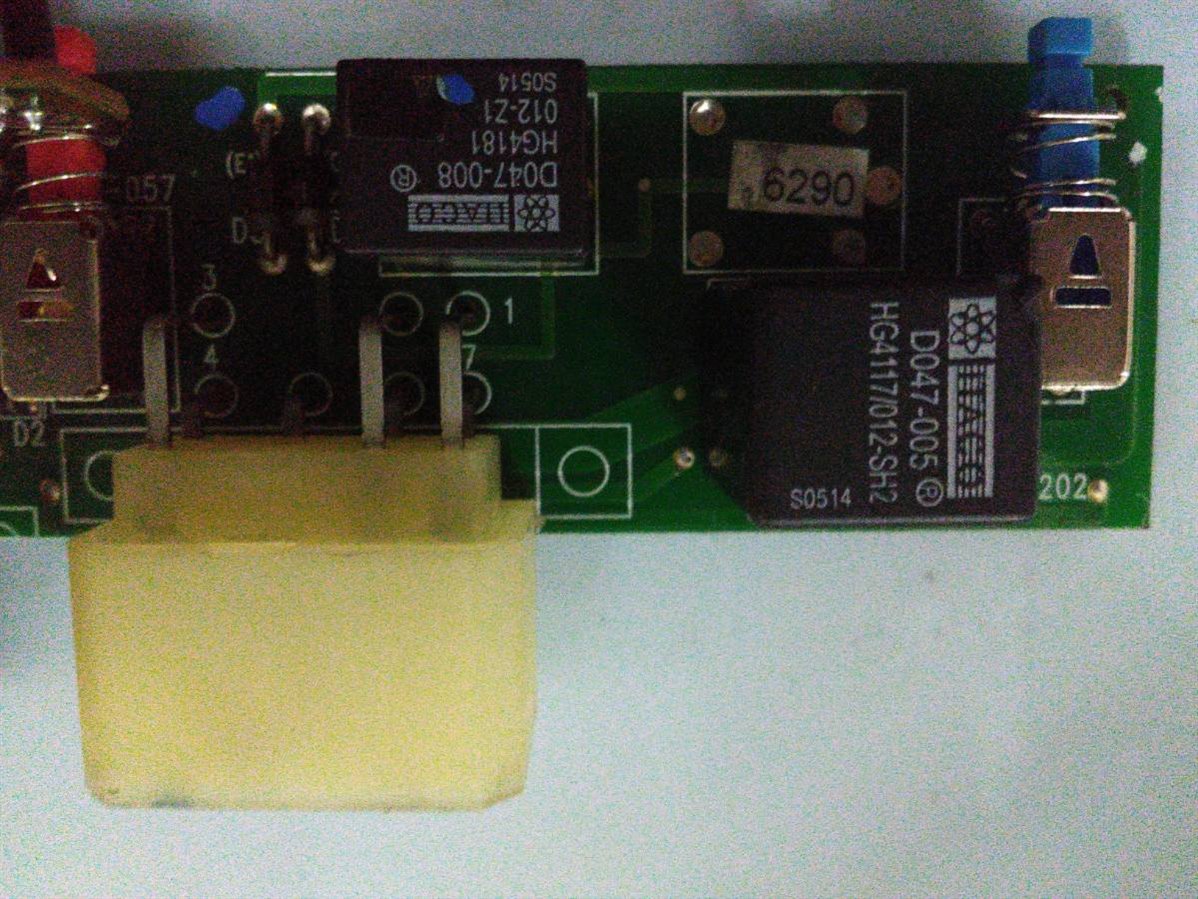

Hi. Where can I get /buy this pcb relay? Its from a pcb on my cars switch module.
I can't seem to find it. pls help.image
    dougw over 5 years ago +1 suggested
    HG 4117 seems to be a fairly common generic family of automotive relays. http://www.tyhhk.com/pdf/HG/HG4117.PDF
