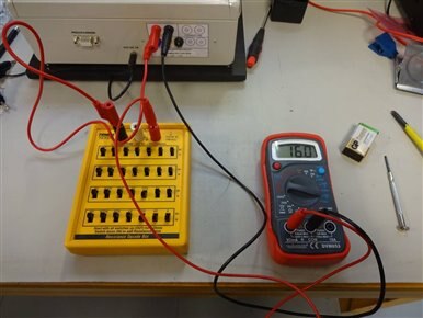

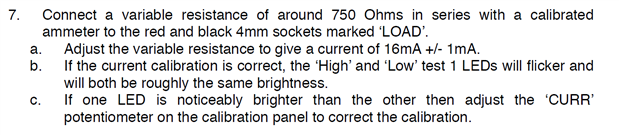

    The specific instruction is below, I have a basic multimeter with the ampere function Velleman DV853, the fixture has a calibration panel which has 4mm red and black Load sockets. Test fixture is 24 volt supply

    Turn ON the 400 and the 200 switches on the resistance box - DO THIS FIRST.
    Set the meter to measure current in the range 0 - 200mA (or as close as you can get.)
    Connect the black terminal of the resistance box to one terminal (doesn't matter which) of the test thing.
    Connect the red terminal of the test box to the red terminal of the meter.
    Connect the back terminal of the meter to the free terminal of the test thing.
    The meter should read a current higher than 16mA, report back if not.
    Add resistance (by switching in extra resistors of value less than 100 ohms) until the meter reads between 15.8 and 16.2 mA - you'll need a bit of trial and error on this.
    Don't get carried away and switch off the 400 or 200 !!
    When you get to the right current do what the instructions say.
    Take a photo and post it  - we need contact with the outside world during knockdown !!

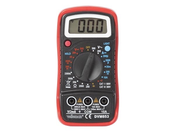

    0 Jan Cumps over 5 years ago in reply to michaelkellett
    They have a DVM853: https://www.velleman.eu/products/view/?id=439012
    Image source: link above
  • michaelkellett
    0 michaelkellett over 5 years ago in reply to Jan Cumps
    Thanks Jan,
    Advice would work - it has 200mA range.
    On a reading of 16mA the error will be about +/- 0.52mA so my suggestion of setting within 0.2mA will be OK (just) since the actual current will be within +/0 0.72mA.

  • richard_bradley1
    0 richard_bradley1 over 5 years ago in reply to michaelkellett
    Success thank you your help was much appreciated.
  • michaelkellett
    0 michaelkellett over 5 years ago in reply to richard_bradley1
    Thanks for the picture - pleased to hear that it all worked.
