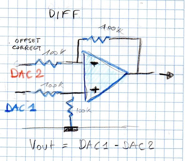

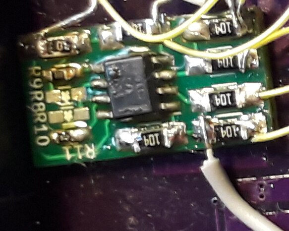

I'm working with a DAC and experimenting with removing the zero scale error - the actual output at a zero input code.  I'm on a breadboard so it isn't particularly accurate but the ZSE is 5mV to 11mV.

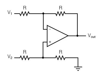

I set up a differential amplifier as follows - image is copied from a website, but I've confirmed and re-confirmed that my setup matches:
So, I have the following inputs:
V1 = 0.005mV
V2 = DACoutput
R = 100K.  All of them.
Opamp is an LM741 which is all I have on-hand, V+ = 5V, V- = ground .  It has a max offset voltage of 6mV.
Given that, I would expect Vout = V2 - V1.  Vout is connected to a 1K resistor to ground.
So the reality is that the R values are not perfectly 100K but are within the 10% spec.  Thus I wouldn't expect Vout to be an exact difference, but 'more-or-less'.
This is what I'm measuring:
DACout (V2) = 4.06V, Vout = 4.04V
DACout (V2) = 0.011V, Vout = 3.6V
I've tried working out why with a low DACout I'm still getting a large Vout.  Measuring the resistors and plugging them into the gain formula:
Vout = -0.005 * (99.03/99.5) + 0.011 * (99.21/(99.05+99.21)) * ((99.5+99.03)/99.5)
Vout = (-0.005 * 0.995) + (0.011 * 0.500 * 1.995)
Vout = -0.005 + 0.011 = 0.006
So, essentially, my calculation confirms what I would expect the amplifier to do with a -0.005mV and 0.011mV input.
I can't figure out where I've gone wrong, can anyone give me some pointers?

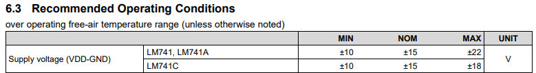

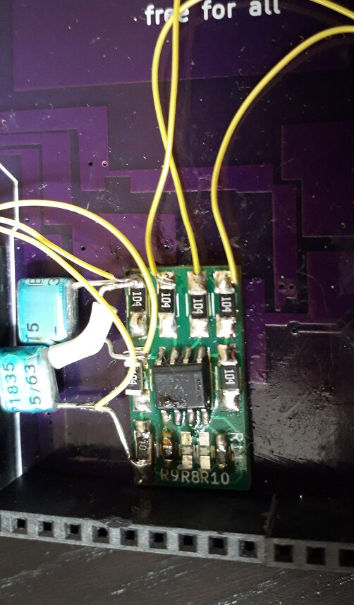

    What power do you have connected to the 741 - it's not rail to rail capable it needs positive and negative supplies, +/- 10V is the minimum recommended. The input common mode range is +/- 12V when running…
  • michaelkellett
    michaelkellett over 5 years ago in reply to Andrew J +5 suggested
    If you want to sink any current at 0V you need a negative supply. You could consider using +/- 5V supplies (+/- 10 if you stick with the 741 ) You can do a lot of this without spending money by using a…

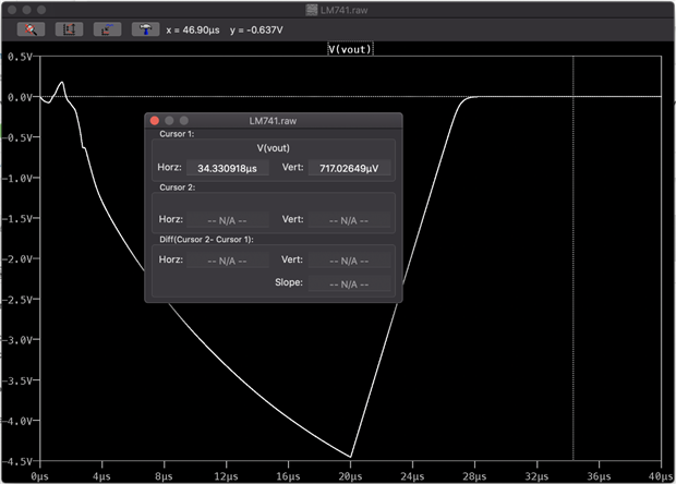

    To follow this up.  I ran a small test with V+ at +15V and V- at -15V.
    As predicted by others in this thread the op amp isn't really up to the job.  The original issue which drew my question is solved - it needs the -ve rail - but it shows its limitations.  I can't even null the offset error.
    Here's the results of two tests for given inputs, the resulting output:
    1. DACout 12.6mV, Voffset 12.6mV, Vout = 44.6mV
    2. DACout 4.0631V, Voffset 14.2mV, Vout = 4.0948V
    So it's not exactly subtracting!

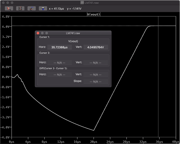

    I also created an LTSpice simulation for these tests:
    Test 1
    The -4.5v drop at the start limits the V scale, but the cursor measurement shows a drop to <1mV
    Test 2
    Here, it shows a correct subtraction.
    So LTSpice simulation is proving the principle even if a physical part can't quite live up to it.  I'm now looking into Op Amps in more detail to get a better idea.  Thanks to Michael and Wolfgang for their input on this.
