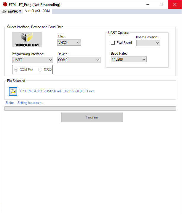

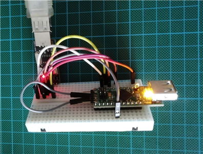

I've been trying to load a new firmware into a V2DIP1 module using the FT_PROG utility. But it seems to stall when loading, with the last message being "Setting baud rate..."
I'm wondering if my issues is the serial adapter I'm using, it has a DTR and CTS connection rather than the RTS, CTS connection on the official cable.
I have logged an query with FTDI and also I've got the official debugger on order but wondered if anyone had got this module programmed successfully using the UART connection.

    I got the official debugger / programmer and that works fine. So I'd advise getting that along with the module if you need to change the firmware on this board.

    Well worth investing in the debug module as it allows you to step through the code running on the module, inspect variables etc
