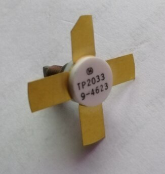

Can anyone help mayermakes ?

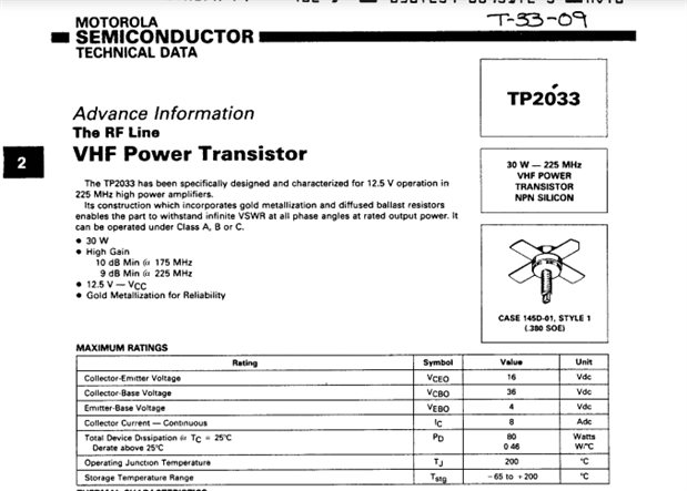

Does anybody have a pinout for power transistors in 145d-01 case? The datasheet does not say anything

    Gough Lui over 5 years ago +3 verified
    Hi cstanton , mayermakes , Not my area of expertise, but I think I have an answer for you - I looked up ASI's Cross-Reference List: ASI - RF Power Transistors - Cross Reference List The TP2033 is referenced…

    mayermakes over 5 years ago in reply to Gough Lui +1
    thank you very much this is indeed what I have been searching for! THats what I love so much about this community!
    The TP2033 is referenced to the VHB25-12S. The datasheet says the following:
    No guarantees, but it's probably going to be closer than a blind guess.
    - Gough
