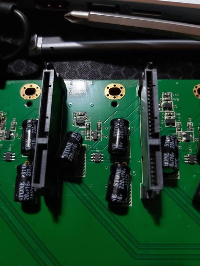

Hi,
I am working on this repair. The second drive does not get detected so I took it apart. There is one part un particular that has burnt. The part would be N520 but I am unsure of what to look for as replacement. Can anybody help me?
Thank you and have a good day.imageimage

    JX9005 20MNMR N520 SOT 23 Replace the electrolytes too.

    0 doudly over 5 years ago in reply to Jan Cumps
    Thank you Jan Crumps.
    Good point about the electrolyte. I admit i was forgeting about those.
