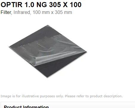

It has been suggested to me , by placing the OPTIR 1.0 NG 305 X 100 Filter Infrared film over the pir sensor screen would stop the interference between the camera and PIR sensor……any thoughts or optional suggestions would be appreciated.

    I also was advised to try wrapping the PIR in foil, again this test  did not change the result.
    I wonder if , as  the PIR was imported from China , if an aussie manufactured PIR work on different frequencies?
    I have even had the suggestion to add the film below over  the PIR screen?

    Pretty strange. There can't be much coming through the foil that would trigger the sensor.
    How far away does the sensor need to be before it doesn't react to the camera?
    You might be able to filter the trigger with a capacitor so a really short noise spike won't cause a trigger.
