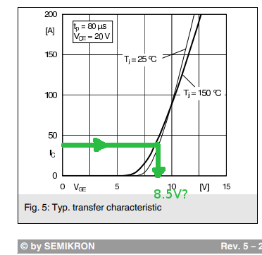

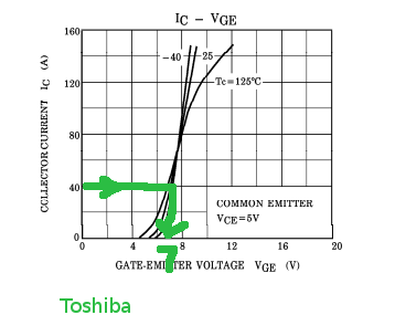

  • jc2048
    0 jc2048 over 4 years ago
    The threshold of the Toshiba part is lower and the transconductance is higher than the Semikron device.
    I drew the 40A case, and then realised it would have been easier just to point out that the Toshiba part manages 100A at 8V gate drive and the Semikron part needs over 10V at that current, which you can quickly see from the curves.
