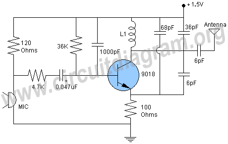

    0 magnus2112 over 12 years ago
    Thanks for the help!  Found this simple circuit online image image
  • michaelwylie
    0 michaelwylie over 12 years ago in reply to magnus2112
    I'm not sure how much you know, but the basic circuit you have shown is an oscillator where the oscillator frequency can be slightly modified by the microphone. The values of L and that 36 pF capacitor are creating a tank circuit which defines the carrier frequency. Do you need more than this?
    Another thought I had, I think this configuration is a Colpitts oscillator. You could possibly look that up for more information.
  • D_Hersey
    0 D_Hersey over 12 years ago
    These little oscillators are nifty to demo RF, but they aren't as stable as modern designs that use PLL or DDS, which use, typically, a crystal for their reference, unless they are thermally stabilized and stuff.  Spectral purity can also be an issue with the simplest jobs.
