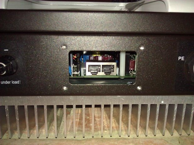

I wish to add terminating resistors to my Ever solar TL2000AS inverter RS422 output terminals for the Ever solar Solar eye data logger which works most days but some days it just will not communicate, could be firmware problem, but would like to try the RS422 resistor terminators to see if this fix's the problem, just not quite sure which terminals to put the 120 ohm resistors, see attached JPG image for the terminal connections.

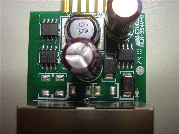

    The Ever Solar, Solar Eye wireless unit is connected to the inverters RS422/485 interface board via a short 500mm RJ45 cable and the interface card has two ports to allow daisy chaining of other Inverters or devices.
    The problem with the Solar Eye wireless data logger unit is that it works most of the time, but for some reason there are days it will not work at all and powering the inverter off then on does not fix the problem, I have contacted the manufacturer but they no longer manufacture the unit or support it any longer, it could be a firmware problem with the wireless unit as my Brother-in law has the same Inverter and Solar Eye and he has the same problem.
    If it is a firmware problem I can live with it, but if it is something like an unterminated unused RS422/485 port "see attached JPG image" then do you think adding termination resistor's to the unused port with an RJ45 connector would eliminate any reflections or noise if there are any?
    Regards Andrew
    ndrewimage

    Yes that is correct, I can turn the Inverter off then on, repeat the binding procedure and no go, then leave it, and the next day it will be working fine, as you can see the RJ45 cable is short so you would not expect any terminating resistor would be required.

    the Ever Solar RS422/485 interface card

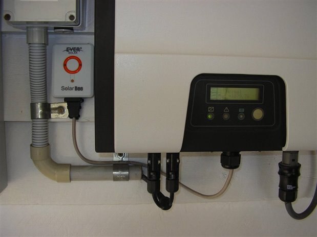

    To Mark, I am aware of those sites, the system I have is manufactured by the Manufacturer of the Inverter, Eversolar, now named Zeversolar who are now owned by the SMA company.
    The wireless setup consists of the transmitter unit which is in the above images called Solar Bee and a wireless receiver unit called the Solar Eye which displays Inverter information on an LCD display and stores Inverter power data onto an SD card for viewing on a PC in CSV format.
