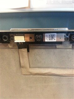

I am hoping someone out there can help me with an issue I am having.  My 11yr old son and I have a Dell webcam that we took out of an Inspiron 1525, the model of the web cam board is 06P231A and the camera is a CN0DP157.  We have successfully been able to connect the first for cables, black, green, white, and red to a USB cable and get the camera up and working.  We now are trying to get the microphone to work, but not 100% sure where to start.  The board has 2 microphones and 3 remaining cables, they are purple, lime green and light brown (i hope I am not too color blind at 10 PM).  We only have a multimeter to test with.  How can we tell what the pin out is on this, and can we just connect this up to a 3.5 mm jack and plug it into a mic port on a PC.  Any help on this would be immensely appreciate.

    Hi Brian, if you have some close up pictures that might also help. Are the microphones on a separarte board, or on the same board as the webcam?

    Here is a pic of the camera and mic board.  The four wires to the left were the USB for the camera.  It is the 3 wires to the right.  The Mics are inside the black rubber pieces next to the screws.

    Can you probe the microphone leads (they're through hole I guess?) when USB is plugged in? I wonder what voltage you'll see on those pins.

    I will give it a try this evening and let you know what I find.
