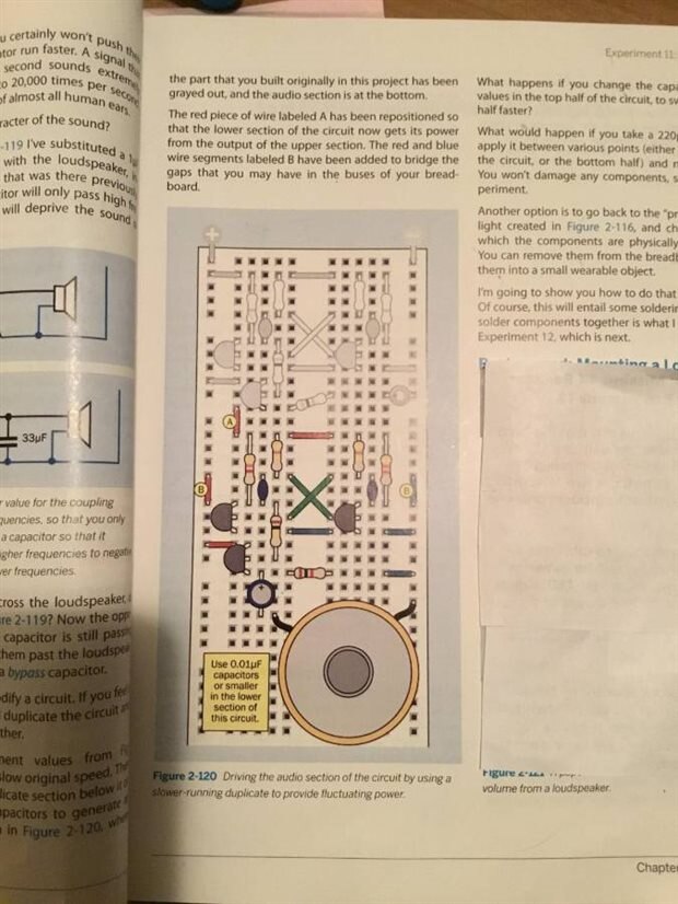

Thank you for all the previous help with Experiment 11 in Make: Electronics.

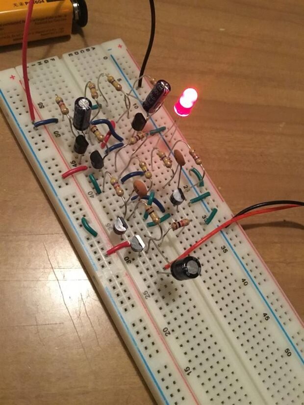

I have now tried the final part of the breadboard circuit, but again I get no sound, although the light does blink as it did in the first part of Experiment 11.
I have attached the relevant photos and diagrams.  The only unusual thing is that the connector wire near the 30 above the negative lead of the speaker is drawn in Figure 2-120 as perfectly horizontal, which would put it in a gap of the negative bus.  I tried angling it both up and down, but still no sound.
Does anyone see any obvious errors or have any suggestions as to what might be wrong?  I feel that perhaps the power is not making it down to the lower part of the circuit, but I'm not sure where I've gone wrong.  I would appreciate any insight!
    jw0752 over 9 years ago +1 suggested
    Hi, Yes the 100K Brown Black Yellow is plugged into the collector of the transistor when it should go to the center Base pin. John

    jc2048 over 9 years ago +1 verified
    Also, the black lead of the speaker doesn't connect to anything. The '-' rail is split into two sections (where the gap in the blue marking is). Either put in a link across that gap to join the two blue…

    Also, the black lead of the speaker doesn't connect to anything. The '-' rail is split into two sections (where the gap in the blue marking is). Either put in a link across that gap to join the two blue segments together, so that the battery '-' can get all the way down the board, or move the speaker's black wire so it connects somewhere on the top section.

    0 os·cil·la·tor over 9 years ago in reply to jc2048
    Thank you Jon, that did the trick!  You can see in the video below that I simply moved the black lead up a bit.  The kit speaker is dreadfully quiet, so you may have to turn up the volume to hear the oscillations.  I experimented with different capacitor values to change the speed, as suggested in the experiment.   On to the next chapter!
