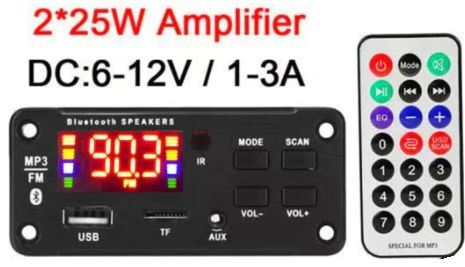

    The best one for me is a BT card like this in the picture, do you know something similar?image
    dougw over 3 years ago in reply to willtwomarc
    I don't think you can pair a bunch of these to the same BT audio source at the same time.

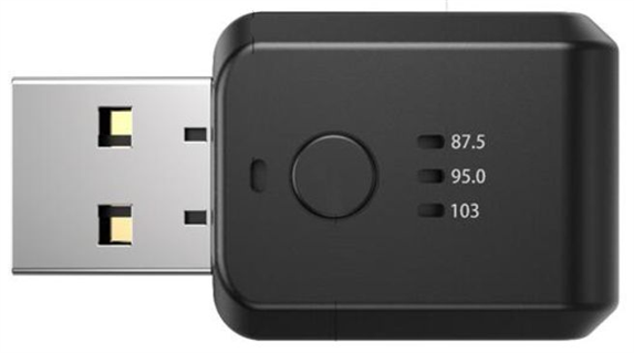

    You could use a Bluetooth to FM transmitter like this: (cost < $6)
    Then on each speaker you could put a small FM receiver amp like this: (cost ~ $6 for each amp)
