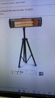

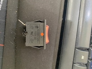

Hello, I am looking for an electric switch KCD3 15A250V/125V T125/55
It is for a heater and it melted cuz we left the heater work all night :(
I can't find it online, Is there anyone that can please let me know if i can use an other type of switches or where i can find this one so i can fix my heater.
Please and thank you
I try to contact the seller but 2 weeks now and no answer, i read the pdf of my heater and the switch is not mention at all.
no help from the seller....

    Hi,
    I think you may struggle to find this, that's a very high temperature range (up to 125 deg C) switch intended for heaters, and it doesn't seem available in small quantities.
    I have looked for alternatives but the ones I found listed (e.g. R1101F2LBWW and  R1101C2NBB )are obsolete or out-of-stock, and they might not be the same size either.
    It should not have melted like that, if there is any product warranty, it's best to use that, granted that's difficult if the seller doesn't respond : (
