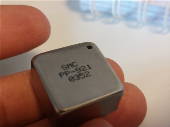

Hi everyone,
The makers space was throwing away some old and unused electronic components and I noticed a weird looking one. I looked up the part number but didn't find anything sensible. Does anyone have an idea of what it is or what it does?
Thanks!
Vansh

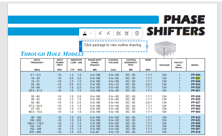

    Datasheet Archive PP-921 datasheet download I tried to reply before but my comment is rejected as spam PHASE SHIFTER plug-in MODEL: PP-921 Synergy Microwave Corporation FEATURES: ► Over 90º of Phase…
  • javagoza
    javagoza over 3 years ago +2
    When I have to look for information of this type, I go to Yandex, which does not interpret searches for you as much as Bing or Google with their AI or "artificial stupidity" PP-921 datasheet & applicatoin…
  • Andrew J
    Andrew J over 3 years ago in reply to javagoza +1
    I was just about to post the same thing! Phase shifter.

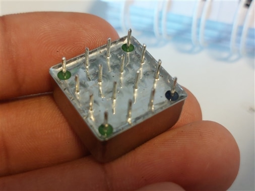

  • michaelkellett
    michaelkellett over 3 years ago
    My guess is that its a crystal or crystal oscillator.
    It has four active pins and the rest are connected to the case.
    Try measuring resistances and capacitances between pins.
    MK

    vanshkothari over 3 years ago in reply to javagoza
    OMG! Thank you so muchh!!!
