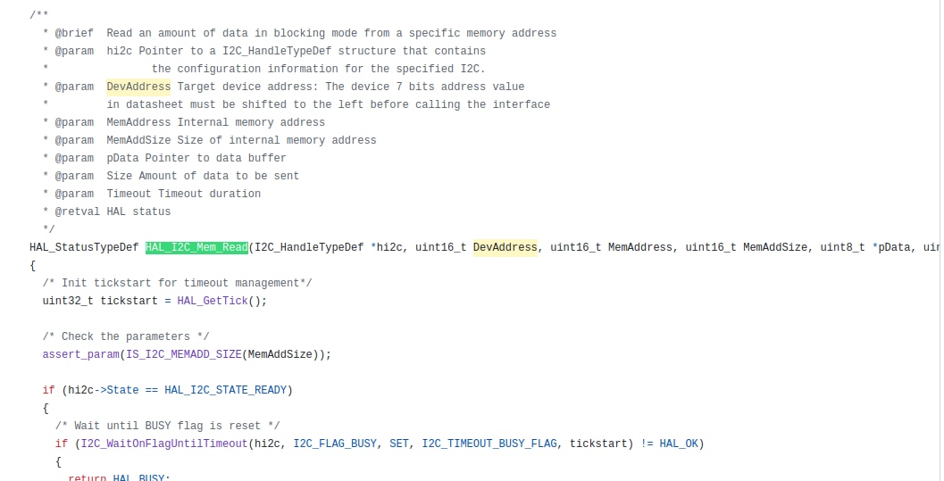

    Two points here
    1)  Make sure that HAL_I2C_isDeviceReady is returning true. else you can loop it until the peripheral is ready
    2) Looks like your HAL_I2C_Mem_Read function call is made with the wrong parameters.
    #define MPU9250_ADD_WRITE       0x68<<1
    #define MPU9250_ADD_READ        ((MPU9250_ADD_WRITE)|(0x01))
    HAL_StatusTypeDef ret1 = HAL_I2C_Mem_Read(&hi2c1,MPU9250_ADD_READ,114,1,&fifo_count[0],6,100);
    You don't need to explicitly toggle the LSB for read and write.
    @param  DevAddress Target device address: The device 7 bits address value
      *         in datasheet must be shifted to the left before calling the interface
