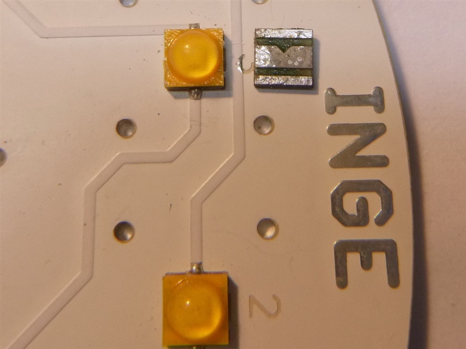

Hello
can someone help with led
this is mounted onto a aluminium heat sink so hard to get off
size 3535 white
normal has 2.9v @250ma across it
this does not  have + in the corner like CREE XT-E
looking at attached photo at underside of dead one
showing 3 solder strips (middle one has a triangle)
where lumileds HL2X has a circle
this is in a network light fitting   made by INGE   PLT210
THANKS FOR LOOKING

    The notch version is an alternate footprint: Here is an example datasheet... https://downloads.cree-led.com/files/ds/x/XLamp-XTE.pdf

    CREE  XLAMP® XT-E LED have this footprint.

    dougw Probably a generic copy of CREE.

    Hello the data sheets i looked at for cree XT-E had the 3 solder strips but not the triange.
