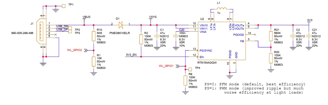

Hello, I am new to electronics and I would like to make a power outage alarm with a Raspberry Pi Pico 2 circuit that I bought as a kit. The Pico would be connected via USB and when a power outage occurs, a two-hour timer would start and after these two hours an alarm would sound. The circuit would be powered by a 9 volt battery for two hours. The alarm could sound for one minute with a bib every two seconds. If the power comes back on before two hours, I would like the timer to reset. Do you have any solutions to suggest or examples of circuits adaptable to this project? Thank you very much for your help.

    Sounds like a school homework project. Here are some hints.
    Firstly, you need to look at the pico power supply circuit.USB is 5v . Vin you are saying is 9v, but inside its converted to something else. There should a blocking diode provided so the USB volts doesn't backfeed the Vin if Vin gets lower than USB.
    Use a voltage divider to attenuation the voltage of both USB and battery, and bring in as analog inputs. Use code to set limits and the levels for making low voltage alarms. You'll want to know if the 9v battery is OK.
    Use a counter or real time clock for elasped time. The 2 second delay is easy code, proably an interrupt would be
    Use a piezoelectric buzzer for the alarm. There are integrated circuits that find the buzzer resonance and drive it there so they are really loud.

    if you wanted to keep it simple and be successful, find a time delay after de-energization relay (TDAD) relay with the coil voltage and freq the same as the power supply feed for the fridge and freezer.  One example is ABB 1SVR730120R3300 Time Relay, OFF-Delay, CT-ARS.21S, 24-240V AC/DC, 0.05s - 10 min, 1 SPDT. It doesnt have the elegance of all the features you want, but after 10 minutes of power loss,  a N.C. contact can connect a 9V battery to a buzzer to wake you up and remind you to start the generator.
    You could also use that relay closure to power up the Pico 2 , and then provide the additional features you want without summing power supplies and attenuating analog circuits to check the power levels.
    This is the control power circuit for the RPi Pico 2. SYS input isnt rated for a 9V battery input, maximum of 5v. You'll need a buck power supply to step down the 9V to 5V ish and a blocking diode so it doesnt backfeed the USB.
