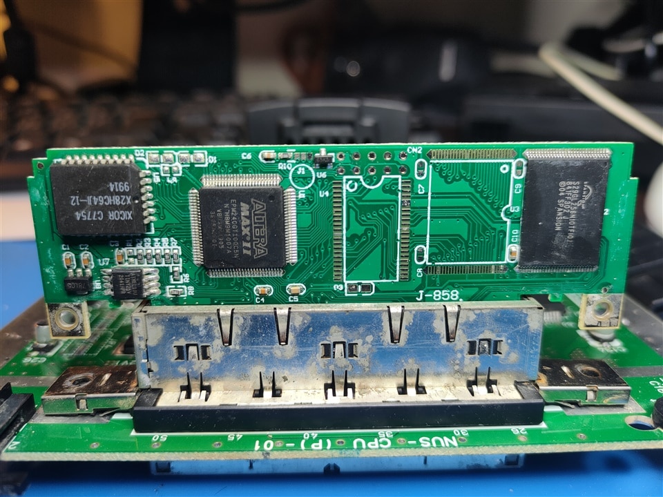

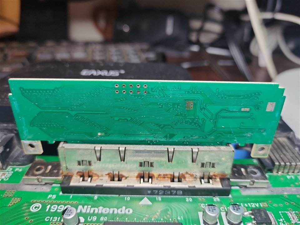

  • kiltro
    0 kiltro 10 months ago in reply to dang74
    Main problem with checking continuity between card pcb and main pcb is that I can't access the pin on the card when it is inserted...
    I would have to trace every pin and see were it goes on the board
    This is one cards that was working btw
  • dang74
    0 dang74 10 months ago in reply to kiltro
    I see what you mean.  I thought there would be obvious visible  traces going to some memory chips.  This looks like a more modern multicart.  The MAXII CPLD for instance didn't come out during the N64 consoles life cycle.  Do you have any old school carts?
