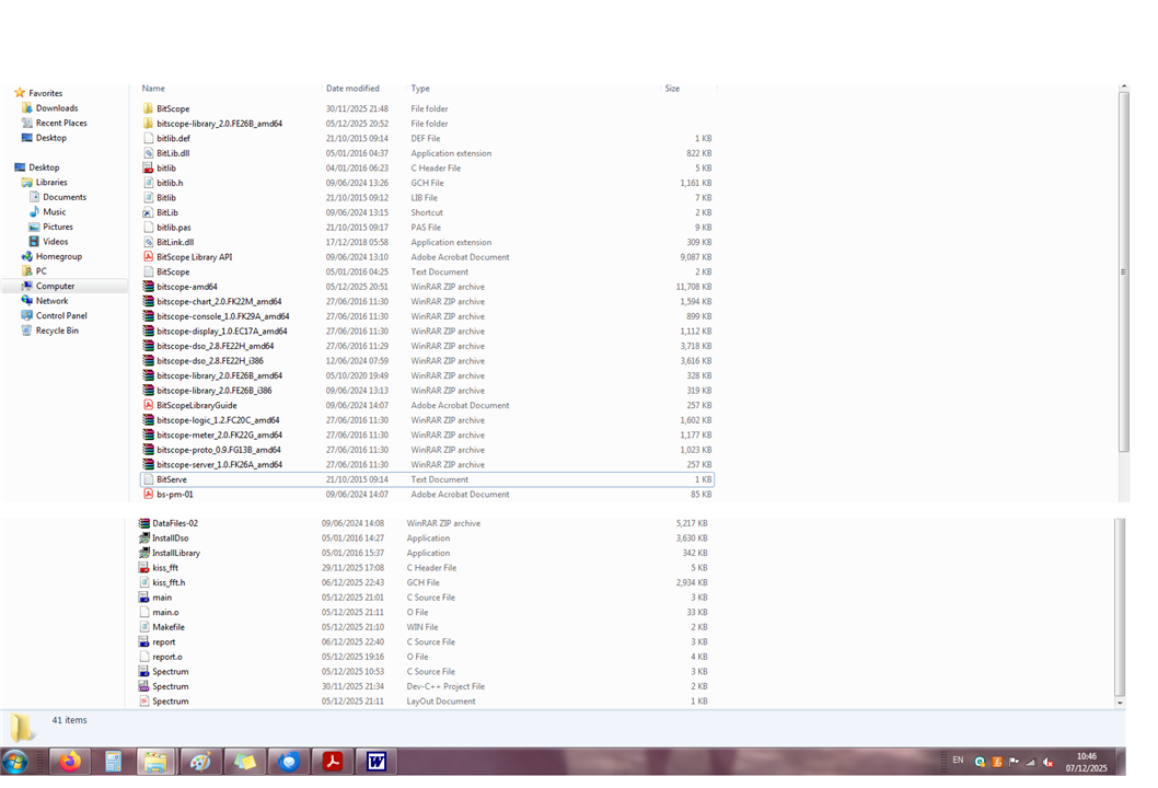

  • ArminAIM
    0 ArminAIM 10 months ago in reply to obones
    Hi obones
    Thanks so much for your quick reply
    I am really a newbie programmer but I need programming to do data analysis.
    Here is my folder structure in which my ".c" folder is.

  • obones
    0 obones 10 months ago in reply to ArminAIM
    Ah, so you are targeting a Windows command line tool.
    Hiding the extensions in explorer does not make for an easier life, but I believe you have a bitlib.lib file alongside the bitlib.h and bitlib.dll ones.
    That "lib" file is the one that should be given to the linker so that it knows where to find the missing symbols.
    I've never used DevC++ but rather C++ Builder, but in any case, you should be able to find a place in the project options to indicate linker details. Either it's a list of additional libraries, or a list of additional parameters. If the latter, then I believe a simple -lbitlib added to the linker's command line should be enough.
    Note that I'm not that confident that it would work because if I read well, it's using GCC, in which case the linker will look for a ".a" file and not a ".lib" file. But, creating the ".a" file from the ".dll" file should not be too hard.

    0 Jan Cumps 10 months ago in reply to obones
    I've been puzzled by the printscreen too. The extensions aren't hidden, but the type column doesn't match the file. I think it's an edited printscreen, not the actual .
  • beacon_dave
    0 beacon_dave 10 months ago in reply to Jan Cumps
    I think they are for 'known file types'
    e.g.
    I think the 'stitch line' two thirds of the way down agrees with you on that one Slight smile
