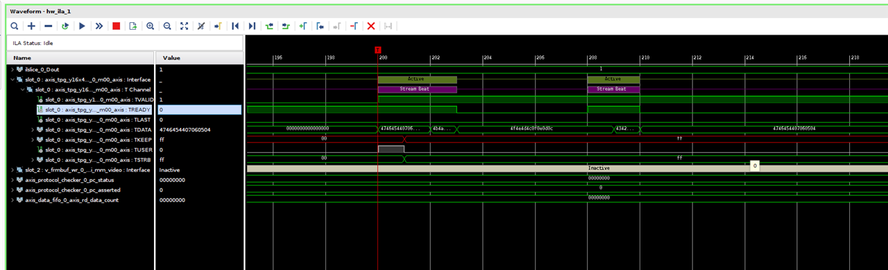

I have created a "test pattern generator" to produce a axis rgba stream. I cannot get the video framebuffer writer to accept the data, here's a ila screenshot:
the data in this case is 128x128 pixels 2pixels/sample = 64bit tdata.
framebuffer writer is configured for alpha channel.

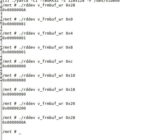

here's a dump of registers on vfbw when I run:
Dump from linux:

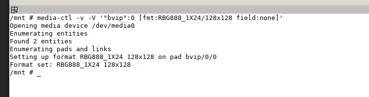

# media-ctl -v -V '"bvip":0 [fmt:RBG888_1X24/128x128 field:none]'
Opening media device /dev/media0
Enumerating entities
Found 2 entities
Enumerating pads and links
Setting up format RBG888_1X24 128x128 on pad bvip/0/0
Format set: RBG888_1X24 128x128

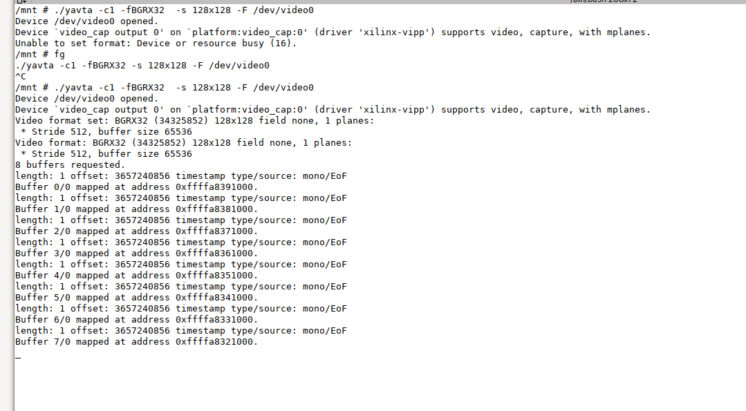

and here's how I run capture.
Ive got it all working with the xilinx tpg, but in that case only with 24bits data, since tpg cannot produce alpha.
Any ideas as to what's going wrong ?
