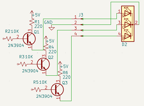

I'm looking for some suggestions on a replacement LED driver circuit for the one above..
I have 10 common cathode tri-colour LEDs I need to drive. I banged out this transistor circuit to isolate the LED's from the Arduino. A HIGH output from the Arduino should light the LED. I've used the transistor circuit on a small scale for driving LEDs. My formal training was in electronics but 20 years ago my career forked to computer networks as a system administrator and the electronics became a thing for hobbies.
I then thought there has to be an easier way. I started newark searching for possible drivers but my lack of practical experience in this area makes it tough. I'm looking for something simple that takes the load of the microcontroller. I found this SN74HCT245N bus driver and thought that might work. Four twenty pin IC's would give me 32 drivers. I need 30 in total. Simple IC's verses all the individual components would make PCB assembly definitely easier.
This is not high speed switching. It is simple on and off control for LED's. I'm hoping the folks that hang out here and do this sort of stuff all the time would have a recommendation for there go to circuits for this sort of thing.

    I've used TI's LP58xx series LED drivers in the past, and was very happy with them. They are a bit more complex than you're looking for, not sure if that's an issue. LEDs are controlled through I2C/SPI, not through individual control lines per LED.
    Is the common cathode LED a hard requirement, any chance you can swap them for common anode? With LP5030, you'd need a single IC and half a dozen passives to drive all of your LEDs. (or if you don't want to bother with soldering a QFN, then use two LP5018, which is available in a VSSOP package).

    If this is too complex and you're looking for something simpler, I'd look into high(er) current shift registers. MIC5891 is the only one I'm familiar with that would be a decent fit(watch out for the minimum voltage specs), it's a bit overkill too and not the cheapest, and you'd need four of them, but it's a simple and robust solution.

    Have a look at the Lumissil IS31FL3218. Get 18 channels, so that drives 6 x RGB's.
  • michaelkellett
    0 michaelkellett 9 months ago in reply to BigG
    But that is a common anode driver chip.
    The MAX7219 will do what you want - the real thing from Maxim (now part of Analog Devices) is a silly price (over £5 in small numbers) but the ones from Aliexpress usually work.
    https://www.aliexpress.com/item/1005009836509792.html
    £1.26 for 10 !!!!
    Free shipping
    My fridge controller uses one of these (from Alie but maybe not the same dealer) and its been working for several years.
    Mine came packed like toffees (ie loose in a bag).
    There is a lot of stuff on the web about using the 7219 with an Arduino - and it is a common anode driver.

    Ah, I forgot to check. I know Lumissil do have other led driver IC's but it's a real trawl through the detail. Here's one "charlieplexed" PWM option, which Adafruit have made into a breakout board: www.adafruit.com/.../2946

    It feels like I've read more spec sheets in the last few days that I did in my career. I have to confess I am intimidated by the complexity of the suggestions. I was thinking a simple in/out chip like a ULN2003. Shows you how old school I am. That chip is manufactured discontinued.
    I found another IC a UDN2981A but it is also manufacture discontinued. I did find stock on Aliexpress. I'm so old I'm looking for a DIP package:)
  • michaelkellett
    0 michaelkellett 9 months ago in reply to colporteur
    You can get the MAX7219 in a DIP package Slight smile
