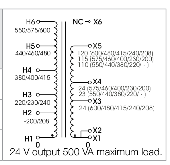

what do the zeros mean on this transformer datasheet?
SensoredHacker0
SensoredHacker0 4 months ago
Im thinking about buying this transformer,
but the schematic symbol has something I don't recognize, and I want to be certain to buy the right thing for the right application
The application is that I want to convert 208VAC to 120VAC. in the 750kVA to 1kVA range
The part I am confused by is what the zeros on either side of the primary and secondary mean.
To wire the primary, I would use A/B phase.
I think what the datasheet is saying is that if I have a neutral I would wire it there, not that I can't use 2 phases.
I'm just trying to verify.image

    I think it's the suggested return terminal. For instance if your AC outlet was between 220-240VAC you would connect one side to H3 and the other to H1. If on the other hand you had 440-480VAC you would…

    SensoredHacker0 said: The application is that I want to convert 208VAC to 120VAC. in the 750kVA to 1kVA range I guess your 208V input would be connected from H2 to H1. Your output would be from X5 to…

    I think it's the suggested return terminal.  For instance if your AC outlet was between 220-240VAC you would connect one side to H3 and the other to H1.  If on the other hand you had 440-480VAC you would connect one side to H5 and the other to H1.  On the secondary side you should be able to measure 24VAC between X3 and X1... and you should be able to measure approx 115VAC between X5 and X1.

    I guess your 208V input would be connected from H2 to H1.  Your output would be from X5 to X1.
