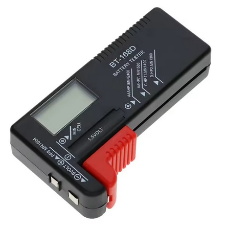

  • dang74
    0 dang74 7 months ago
     obones  for your 9% use case....image

  • obones
    0 obones 7 months ago in reply to dang74
    Well, I have one of these:
    But the reliability is not that good with 1.5V batteries, so I find myself using the DMM quite a bit.
