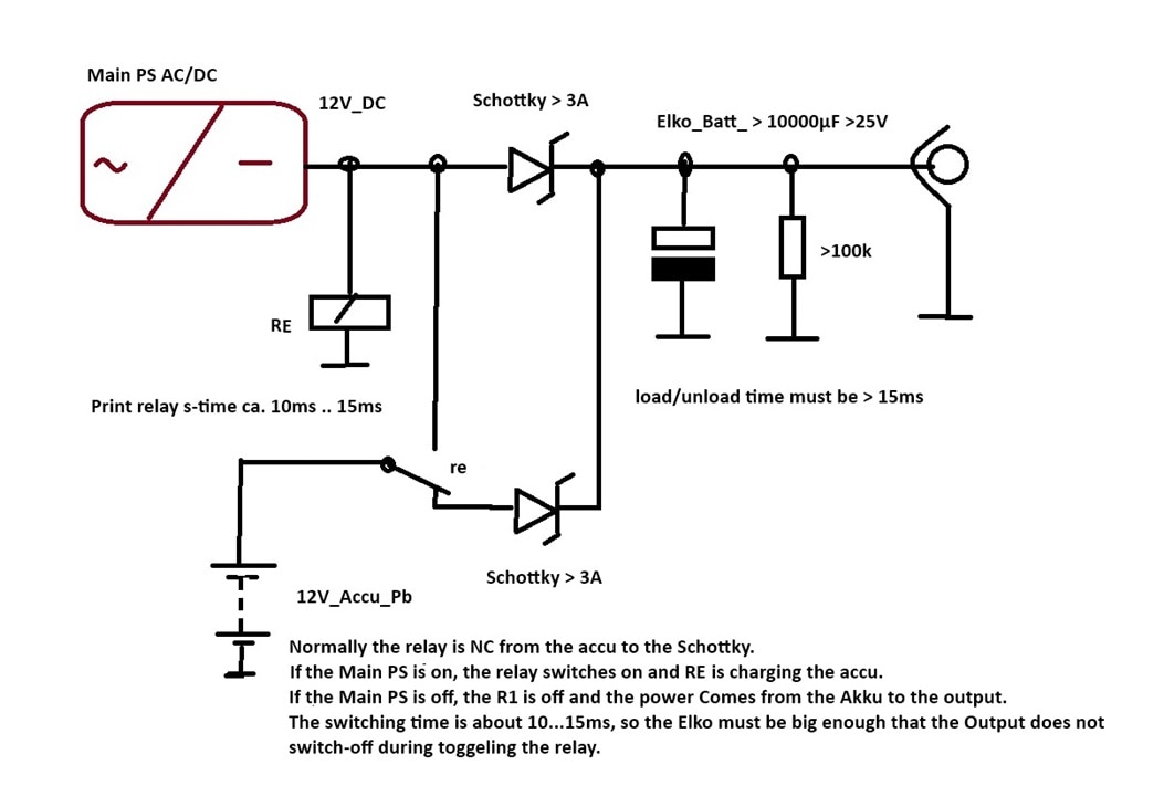

I try to outline a 12V UPS for my router. The commercial things I see are either to complicate, means have to much functions or they use a relay. I want to build a solid state switch that is faster than a relay. I have a first sketch. What do you think thats the right direction?
The battery has her own BMS it's not in the circuit here. The comparator is the watchdog who activates the switch in case of a power outage. There are a few diodes to prevent return current. A few resistor to adjust the components margins. R4 is a trimm-pot. Works as a pull-down resistor and adjust the threshold for the comparator.
PS: I know. The input voltage has to be higher than 12V.

    The comparator and switch are not really doing anything useful. Two diodes will do the business quite easily. Both cathodes to the output, one anode to the 12V DC in and one to the battery. It is…

    Hi look here, an idea: This is a very simple "UPV". The switching time is not the big problem if you make a buffer (Elko-accu) during toggling the relay. It's just an idea.

    I think you will need second resistor connected to R1 to form a voltage divider. Otherwise I think your comparator will always select the battery. The comparator should also have a bypass capacitor connected…
    ups simple
    It's just an idea.

    I think you will need second resistor connected to R1 to form a voltage divider.  Otherwise I think your comparator will always select the battery.  The comparator should also have a bypass capacitor connected to its supply pin.

    The goal is to do it with a solid state switch. No relay. I'll try to modifier this circuit to a solid state.

    I think there should be also some current limiting during battery charging - now, when battery voltage is < (12V - Vd4), it would be charged through D4 with possibly big current (even creating fire hazard in case of - for example - battery cell shortage and powerful PSU), but maybe BMS would protect against it?

    I wonder if putting another diode between battery anode and output wouldn't be beneficial in this case? Than way, big C wouldn't be needed - output would be powered using this additional diode during relay toggle, and in a steady state diode would be shorted by the relay contact, eliminating power loss on diode's voltage drop?

    Solid-state relays are okay—a perfectly viable option. Solid-state changeover switches are a bit komplexer.
    But please don't forget about the leakage current (return current in µA) inherent to semiconductor switches; the battery will feel that.
    True isolation (via a mechanical contact) would be better; that way, you avoid equalization currents, which are also highly temperature-dependent. Leakage currents drain the battery without providing any benefit.
    Don't be afraid to use a relay.
    The "only" potential issue is:
    the contact sticking shut even after the relay has de-energized; the contact joint can melting, current switch off lightning.
    With a DC relay, the iron core can become permanently magnetized if the relay remains energized by direct current for extended periods.
    One possible solution for monitoring this is to use a second contact with an LED to indicate whether the circuit is closed or open.
    A more complex approach involves applying a short negative pulse to the relay coil upon switch-off to collapse the magnetic field.
    This is achieved using a second winding around the iron core (utilizing back-EMF).
    ->> One more point regarding your circuit:
    Make sure to include deep-discharge protection and a charge cutoff for the battery; otherwise, the battery will eventually be ruined.

    OK, now I understand why all the USV I came along have a relay. Maybe I shouldn't reinvent it. Sweat smile
