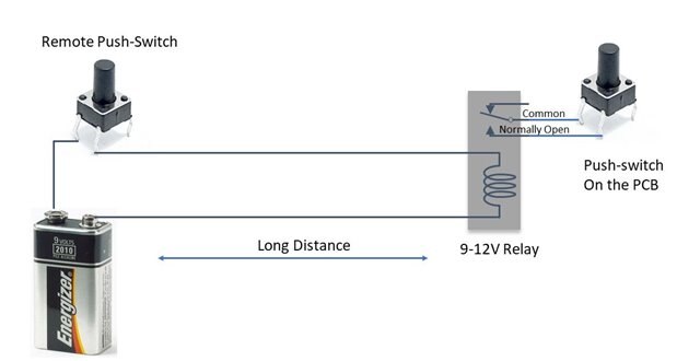

Hi guys,
I' got new flashs strobes that use 'push buttons' to switch from on to off, which is very anoying to says the least...everyday.
I need to remplace the Push Button switch so it can always be 'ON' or always 'OFF", to avoid to push that button everyday.
You'll say ''wow'' this guy is so lazy not to push a switch.... the problem is not push the switch is how I got to do it.
I'm doing cars photography so I got 4 flash from 15 to 25 feets up in the air all the time, so each morning I got to use a large latters to carrefully push the button ON.
It take 10 minutes to do but my biggest problem is security side of it....
Most flash head on the market use 'switch' that kinda toggle from 'On/OFF' This is a safe and a simple solution.
So when you leave the switch to 'ON' you can unplug it at the end of the day, and replug it the next morning to start again it will still be 'ON.
Here picture of the board.
Would be lovely to have an expert to check out this board on how it can be modified.

    This type of button is (usually) under microprocessor control, so it cannot be easily replaced with a slide or toggle switch that retains its state even after power-off. Sometimes this is the result of the product manufacturer not understanding how people will use the product.
    The easiest option may be to wire a push-button switch on longer wires unfortunately. To do that, you could fit a connector in parallel with that button, and then connect wires and a button to it. It would void warranty and could be unsafe unless done carefully away from the mains wiring. If you're careful you should be able to implement it safely, but it will still void the product warrantly most likely.
    Another problem is that the distance is quite long, and it could cause issues. A quick fix could be to use a relay close to the unit, and wire the relay coil down to ground level, and then use a battery and push-button. The battery would last for years if you're only turning the device on and off a few times a day (or replace with a mains to DC adapter). Let me know if you wish me to sketch the scheme and suggest some part numbers.

    I bet you're right cuz the buttons are working with a LCD screen, so I can see the printed circuit going down to microchip in the middle on the back of the board. I don't really care about the warranty, it's better have a broken flash strobe then have myself falling off a latter from 25 feet high....
    I don't really understand it without a diagram...but what you say is doable.
    Would you be kind enough to make a quick drawing of 'how' you see it exactly ?
    Just to be sure I'm not breaking off this strobe in 5 mins..
    shabaz over 9 years ago in reply to redgreenblue
    No problem at all : ) Here is what I'm thinking should be the easiest way to ensure it all works. The push-button on the right is the one you currently have on the PCB. If you can solder two wires to it (the button has 4 pins, slightly flattened as you can see because they are stamped metal, but internally they are just two pieces of stamped metal not 4, so you only need to use two of the pins, one from each piece of stamped metal as shown in the diagram below) and wire them to a relay Common (C) and Normally Open (NO) pins of a relay.
    The coil of the relay is connected to two long wires that go to near where you want to locate the remote push-button, and wired as shown to a battery.
    The diagram above shows how it should be wired electrically, but practically you may wish to also use connectors and a small box and a battery clip too, to make the whole thing more neater/maintainable.
    What the proposed design is doing, is that every time the remote switch is pressed, it completes the circuit that provides power to the relay coil. The energised coil makes the Common and Normally Open pins of the relay momentarily connect together for as long as the remote switch is pressed. Since these pins are wired across the existing push-button switch on the circuit board, it behaves like someone has pressed that push-button. The relay has an internal gap between the switching contacts and the coil, so that provides a lot of safety. Furthermore, any electrical noise in your workshop that is picked up by the long wires won't accidentally trigger or damage the flash unit, because the electrical noise cannot cross the gap between coil and the Common/Normally Open contacts.
    Here are some typical parts you might want to use, but to be honest any generic push-switch, 9V or 12V relay that is SPST or SPDT will be fine, placed in any enclosure. For the cable, you could use telephone wire or bell wire. I've also placed a link to terminal blocks below, you could use them to provide screw terminals for slightly neater wiring. Epoxy resin glue could be used to secure the terminal blocks to the outside of your strobe unit, and at the end where the remote switch will be. You'll also need a soldering iron and solder of course.
