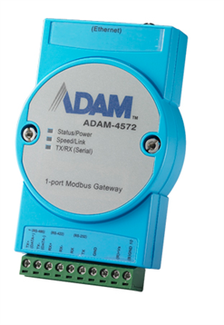

    • If you can connect to a network and have a PC or server available, you could use a Modbus RTU to TCP converter such as the ADAM 4572ADAM 4572 and then connect the Modbus devices to your network via this.  You would then need some software on a PC or Server to Poll the data from the devices and save it to a specified location.  There are a few Modbus applications available on Sourceforge that may do the job.  I have not had experience using these so cannot comment on which ones would work and which would be best.  Of course if you have any existing SCADA software tools available such as Wonderware, you could use these.
