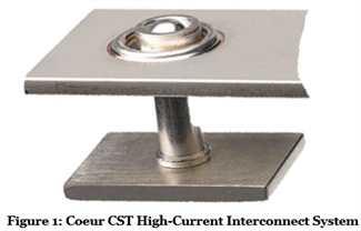

The quality of an electrical connection system depends on several factors, including contact resistance, contact force, contact material, and resistance to contact surface layer degradation. Contact resistance is one of the most important factors in establishing a reliable electrical connection. The higher the contact resistance, the greater the quantity of heat released by the contact. If contact temperature increases above the design limit, the contact will deteriorate -- soften, melt, and ultimately fail.image

To accommodate pin to socket connector misalignment, the Coeur CST High-Current Interconnect System employs a float design where the entire core socket assembly can move within an outer housing. The float technology provides up to 1.00mm of axial float, which moderates any misalignment of the male pin to the female socket during connector mating. This solution is ideal for applications where the need for float is critical, such as power distribution mechanical packaging.

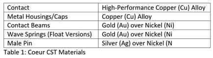

Contact materials also affect the quality of the electrical contact. Some materials inherently have low contact resistance, such as silver and gold. But gold is expensive and silver does not have good mechanical endurance. Copper has good electrical conductivity but tarnishes and pits under an arc. Brass (copper-and-zinc alloy) is cost-effective and very easily machined. Yet brass experiences frictional wear and oxidizes at ambient temperature, which increases its contact resistance. Under an arc, brass pits, which allows in-depth oxidization. Silver-nickel alloys are often used because they combine the low contact resistance of silver with the durable mechanical properties of nickel.image
Contact plating is also part of the quality equation, so to speak. Tin needs a very high contact force to remove accumulated surface oxides  on the contact surface layer. The downside of high contact mating forces impacts durability and the life expectancy of the contact. Gold plating, albeit more costly, tends to be free of oxides, and thus low contact mating forces are permissible. The Coeur CST High-Current Interconnect System utilizes a combination of contact materials to enhance conductivity while maintaining durability.

The Coeur CST High-Current Interconnect System delivers up to 200A through 3 diameter sizes (8.00mm, 6.00mm and 3.40mm) and offers a wide range of configurations to connect PCBs, busbars, and cables. CST connectors offer a flexible design to meet a wide range of high-current applications. The connectors feature a low profile, where the male pin does not protrude above the socket housing when mated by a top entry, to save space above the PCB or busbar.  A common contact design in all CST sockets is utilized regardless of form factor sizes. They have fully shrouded female and male contacts, making them touch safe. Options include mate-first-last-break option, positive latching, panel-mounting (vertical, right-angle, PCB, and busbar mounting header). Coeur CST applications include data center solutions, including circuit breakers, data storage, instrumentation, PDUs, routers, servers, switches, UPS/battery storage, and more.
