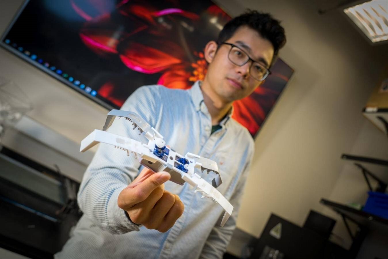

Ph.D. student James Jian demonstrates one of the 3D printed flexoskeleton robots. They only take 10 minutes to print the parts, and they cost just under $1. (Image Credit: UC San Diego)

It took one flexoskeleton just 10 minutes to print, which can be done using most inexpensive commercial 3D printers, and the materials only cost under $1. It takes less than two hours to print and assemble the entire structure of a flexoskeleton robot.
