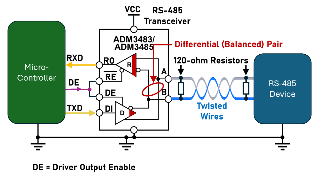

RS-485 Refresher
It’s a three-wire system (two carrying serial data in differential (balanced) pair, and a ground or 0V reference wire) and multiple devices can connect to it. The two balanced wires are called A and B, or Normal and Inverting respectively. When one of those two wires is high with respect to the 0V connection, then the other wire will be low, and vice-versa.
Transmit and receive can occur over the same set of wires, therefore it’s best if all devices are usually set as inputs, and only when a device needs to send data, should that device become an output.
Most microcontrollers only offer a UART that has separate connections (often called RXD and TXD) for normal single-ended receive and transmit signals. Therefore, a kind of switchable buffer/level converter chip, called an RS-485 transceiver, is needed, to interface between the microcontroller connections and the balanced A and B wires, and the transceiver must be able to divert the stream from RXD (microcontroller input) to TXD (microcontroller output) depending on if the microcontroller receiving or needs to transmit.
Some RS-485 transceivers can automatically do this, but another technique is to allocate a third pin on the microcontroller, to act as the signal to switch the transceiver direction. Usually, that third wire from the microcontroller needs to go high whenever the microcontroller code needs to transmit, to switch the RS-485 transceiver direction accordingly. That third wire is labelled DE (Driver Output Enable) in the example diagram above.

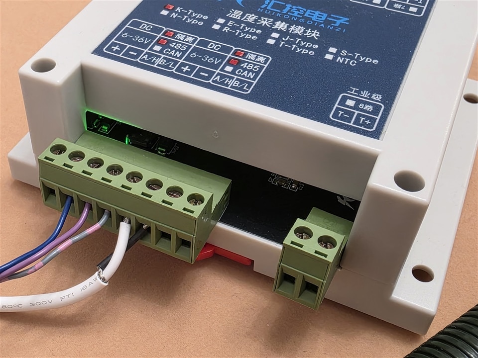

Multi-Channel Thermocouple Adapter

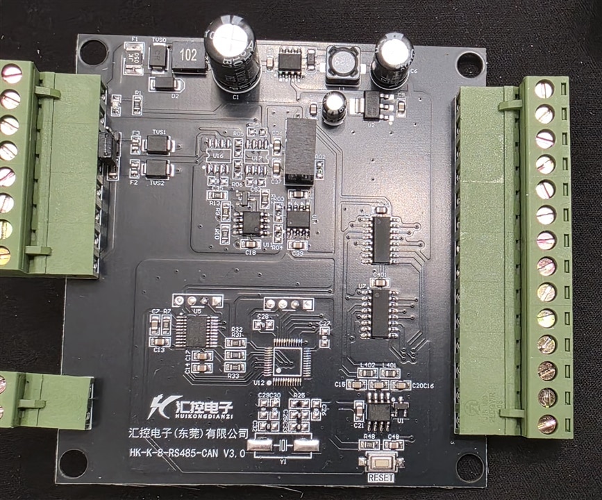

I purchased a low-cost thermocouple adapter, and it’s not bad. The instructions were only in Chinese, so I had to do some auto-translation.
The internals look pretty good, unfortunately I didn't take any better photos.
The product code is HK-K-8-RS485-CAN V3.0 and is called a K-type Thermocouple Temperature Acquisition Series by Huikong Electronics (Dongguan) Co., Ltd.

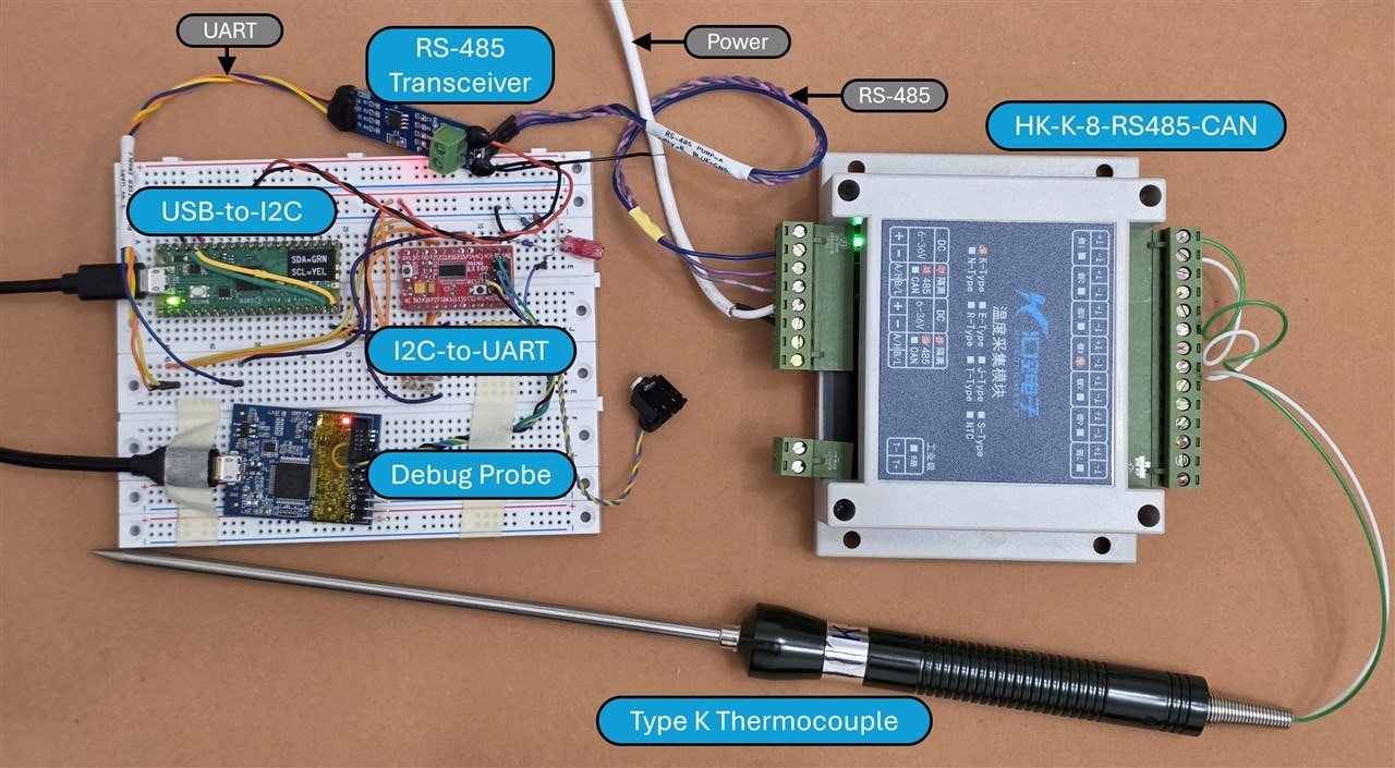

Testbed
The busy photo here shows how everything was connected up. My setup used a USB-to-I2C adapter, followed by a I2C-to-UART adapter, and then the RS-485 transceiver, so it’s more involved than what would normally be done. I had various reasons not important for this blog. It would be far easier to use a USB-Serial adapter followed by an RS-485 transceiver, or, simpler still, buy a USB-to-RS485 adapter.
