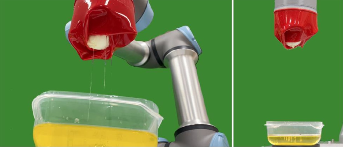

ROSE can pick up all sorts of objects, even if the sleeve is damaged. (Image Credit: JSAID)
Robots must be more careful while grasping brittle objects to avoid damaging them, and one way to do that involves a special gripper integration. JSAIT researchers have been developing a ROtation-based-Squeezing grippEr (ROSE) that can handle objects with more delicacy. The gripper could be used across various fields, including agriculture, for harvesting crops.
The team's rose-inspired gripper features a cone-shaped sleeve attached to a firm circular base that connects to an electric actuator. This actuator causes the sleeve and base to spin. The sleeve wraps around an object whenever ROSE lifts it, causing most of the elastomer to secure around each side. Then, the base rotates, and the sleeve gently crumples and wraps around this object. Rotating the sleeve in the other direction allows it to open again, and in response, the gripper can lift, move, and release the object.

"Soft robot hands, such as those that mimic traditional people's fingers, require producer attitude control, but ROSE robot hands allow large-range contact and closed structures to hold grasp of various objects。 In particular, experimental has shown that traditional robot hands can hold grammatically oil-soaked objects that were difficult," they wrote.
The team claims ROSE is less costly to manufacture compared to existing soft grippers. And since it applies gentle pressure, the gripper can lift many different objects. They also demonstrated its durability in experiments, proving that it can still operate even after 400,000 gripping movements and lifts objects if the sleeve gets torn.

    That does look like a nice implementation, although probably very specific to the size of item it's picking up.
    I recognize the robot they're using it with. I used a Universal Robots UR5e for a recent project. It has a nice interface at the end of the arm for adding whatever gripper you need. (We used a more conventional one.)
