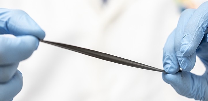

The magnetic skin can be used in laboratory settings, effectively preventing contamination of equipment. (Image Credit: KAUST)

The lightweight artificial skin is made of a very flexible biocompatible polymer matrix that has been mixed in with magnetized microparticles. By using the simple and inexpensive fabrication process, it’s produced in thin sheets that can stick to the wearer’s skin. “It can be customized into any shape and color, making it imperceptible or even stylish,” says KAUST Ph.D. student, Abdullah Almansouri. “Anyone can start their own artificial skin project after a few minutes of training if they have the tools and materials,” he says.
