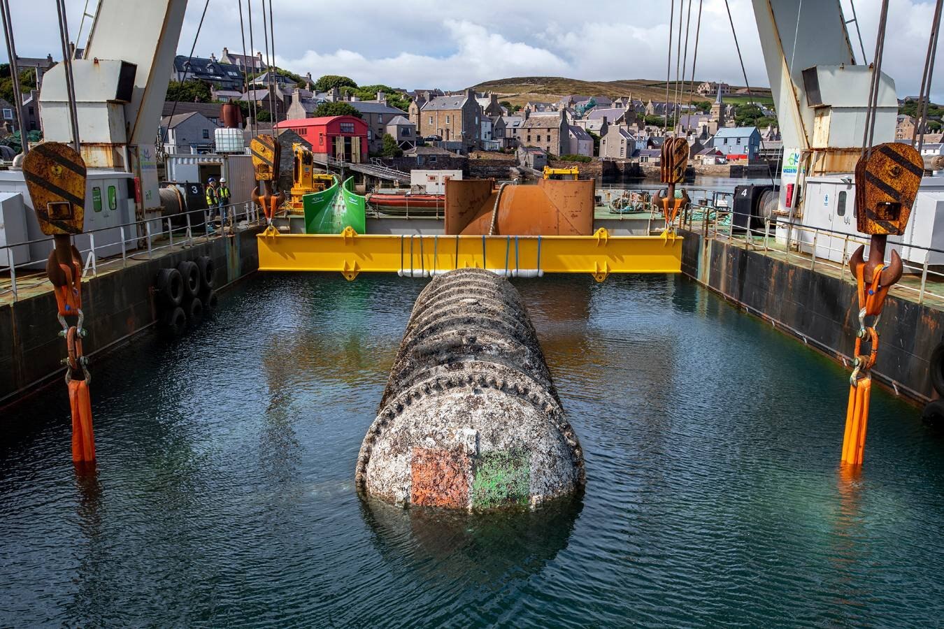

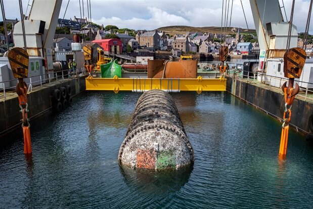

The datacenter was retrieved from the seafloor off Scotland's Orkney Islands. Algae, barnacles and sea anemones grew on the datacenter. (Image Credit: Jonathan Banks)

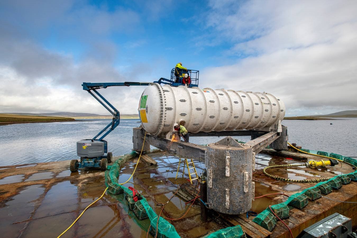

The team collected air samples from the underwater datacenter. It was filled with dry nitrogen before being sealed up for deployment. (Image Credit: Jonathan Banks)image
Before removing the datacenter unit from the pod's hull, the researchers inserted test tubes through a valve on top of the vessel to gather air samples for analysis in Redmond. "We left it filled with dry nitrogen, so the environment is pretty benign in there," Microsoft Special Projects researcher Spencer Fowers said. He also says that there are still questions about how cable and equipment outgassing may have changed the operating environment for the computers.
