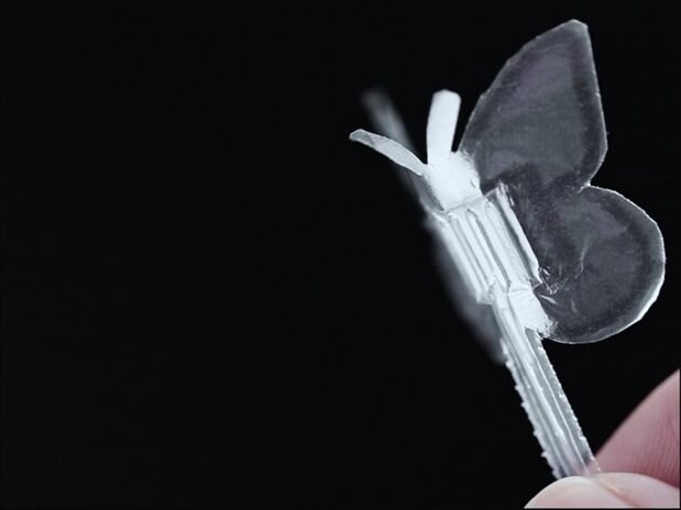

The butterfly robot, created by using the milliMorph platform, can flutter its wings at 10 Hz. (Image Credit: MIT Tangible Media Group)

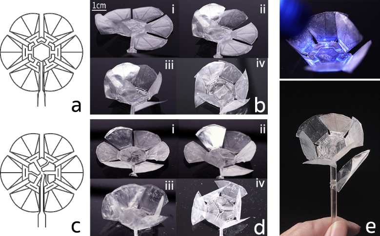

Researchers also developed a flower using the milliMorph, which is capable of folding in a similar way as a real flower. (Image Credit: MIT Tangible Media Group)
MilliMorph can be actuated in two different ways, electrically and non-electrically. The non-electrical method involves using a pipette and squeezing it manually. The low volume of air is sufficient enough to create a shape change. When higher volume, higher flow rate, or more precise control is needed, a compressor, control board, and valves can also actuate the system. Another alternative involves injecting milliMorph with low boiling point liquid, causing it to react to temperature change and alter its shape. In this circumstance, milliMorph can be driven electrically by using heating circuits.
By using the milliMorph system, the researchers were able to develop a butterfly that can flap its wings at 10 Hz when it’s connected to computer-controlled valves, similar to a real butterfly. They also developed a haptic latex glove that changes texture whenever it comes in contact with an object. The team hopes the milliMorph system will be used in various applications, which can be used in future product designs with transformational abilities.
