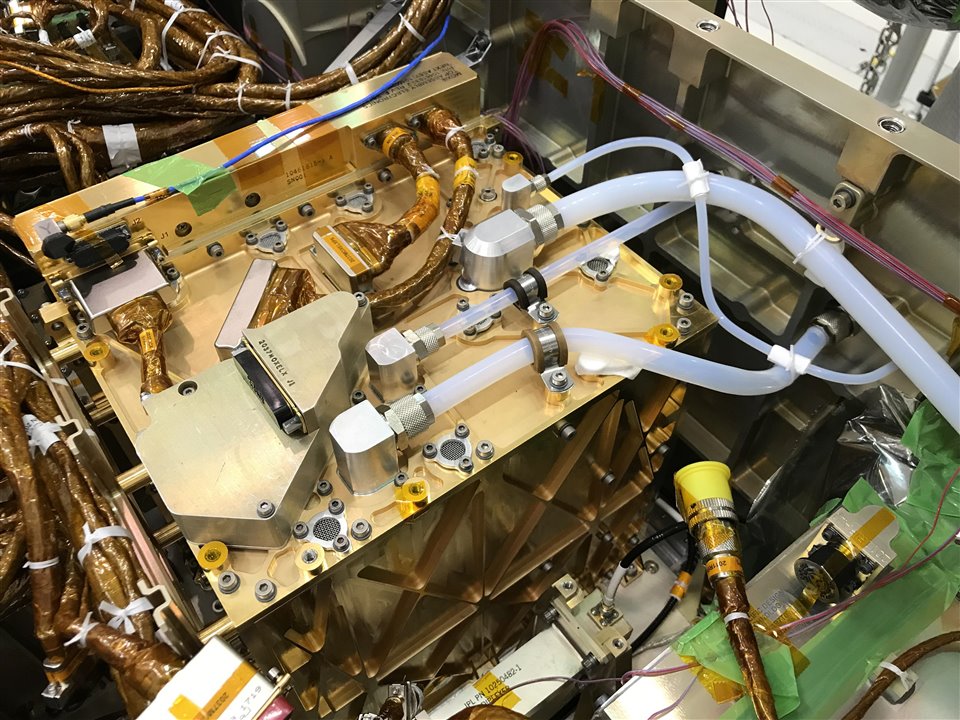

NASA successfully ran MOXIE experiments, converting Martian atmospheric gases into breathable oxygen. The lunchbox-sized device produces six grams of oxygen per hour. (Image Credit: NASA/JPL-Caltech)
NASA successfully performed a crucial Mars experiment that involved converting carbon dioxide from the Martian atmosphere into oxygen. The process relies on using the Mars Oxygen In Situ Resource Utilization Experiment (MOXIE) device aboard the Mars Perseverance rover. It has churned out approximately six grams of oxygen per hour in the Jezros Crater.

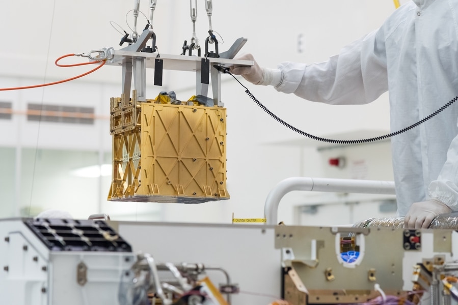

MOXIE continually starts up and shuts down during each run, which may lead to system degradation. (Image Credit: NASA/JPL-Caltech)
NASA engineers also plan on making MOXIE more productive, especially during the Spring, due to high atmospheric density and carbon dioxide levels. “The next run coming up will be during the highest density of the year, and we just want to make as much oxygen as we can,” Hecht says. “So we’ll set everything as high as we dare and let it run as long as we can.”
In addition, they expect to monitor the system for degradation signs. MOXIE cannot operate at all times because the Perseverance rover has more than one experimental system. The carbon dioxide conversion device powers on and off with each run, which causes thermal stress that degrades the system.
