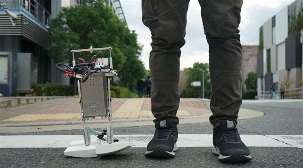

The PedestriANS robot is capable of adjusting its walking style based on its surrounding environment, similar to a human when they’re moving around. (Image Credit: Ahmad et al)

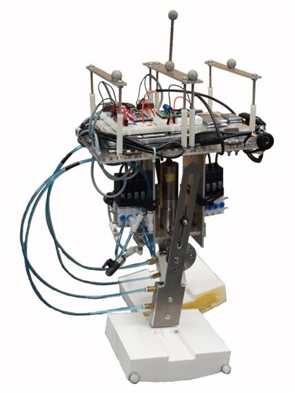

This new robot, PedestriANS, relies on an actuator network system (ANS) to function. The team used ANS in in the past, on projects which included robotic spines, arms and multi-legged robots. A single motor is responsible for its movements with its legs linked together through an ANS. The robot’s structure is also fairly simple, allowing it to easily adapt to changes in its environment. This is achieved by exposing physical characteristics of its legs and interactions between its components, which produces different walking behaviors.
The researchers plan on adding an AI system to the robot so that it will be able to autonomously adjust its walking behaviors without human intervention. (Image Credit: Ahmad et al)image
