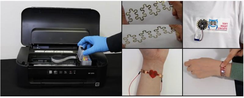

It’s common to use printers to print out documents, but what if we could use printers to print out flexible devices, such as temporary tattoo paper, textiles, and thermoplastic? Engineers from Saarland University based in Saarbrucken, Germany, have printed soft circuits by using an inexpensive desktop inkjet printer with raw materials. Their systematic approach produces high-resolution circuits that are stretchable, ultrathin, and can be integrated with a wide range of materials used for prototyping. The team published their Soft Inkjet Circuits findings in a paper.
The inkjet printer prints out soft circuits that can be used as textiles, tattoos, stretchable circuits, and interfaces that can be re-shaped.  (Image Credit: Saarland University, YouTube)
The team was able to achieve circuit printouts by modifying a desktop inkjet printer with multi-ink functional printing. Their technique supports multi-layer printing of various inks with different functions, which includes highly conductive silver nanoparticle ink, stretchable conductive polymer ink, and an electrically isolating ink with graphical inks. These special inks can be combined in a single printer, allowing it to be used for different purposes. According to the paper, “By printing an isolating top layer, circuits can be selectively isolated, while leaving desired elements exposed.” This gives it a quick process for creating exposed electrodes, connection pins, or VIAs that connect the circuit with an additional layer. Printing conductive and graphical inks allows full-colored designs to be printed with the circuit in one pass.
By matching the functional inks with various sets of soft substrate materials, the team was able to create advanced mechanical properties for the circuits. It includes highly stretchable Thermoplastic Urethane (TPU) foil, 1-microthin rub-on tattoo film, textile transfer film, and re-shapeable thermoplastic materials.
